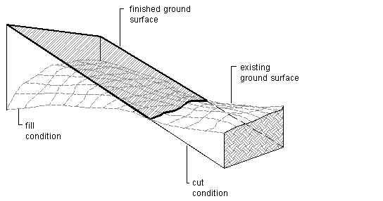

Hello Forum,
I have just started using Civil 3D and I am a novice
I would like to calculate the volume of excavation from an existing ground level survey and a finish level AutoCAD drawing. The finish level AutoCAD drawing is not a single base level but is a large site with various required foundations at different levels.
Please advise
You will need two surfaces.
You say the first one is an "existing ground level survey" - so do you have a C3D surface made from this, with the correct break lines added, etc?
For the second one, you say "finish level AutoCAD drawing" -- what is this exactly? Does it contain 3D data?
Take a look at this graphic. Your surfaces need to be on the same X,Y,Z reference, so C3D can do what is shown in the graphic below.

Rkmcswain has given you the answer the volume between 2 surfaces.
A couple more comments the surfaces must be contained, eg second surface is fully within existing surface, or both have a matching outer boundary. If you have lines and 3dpolylines etc then you can use the make surface from Definition, drawing objects, LINES. You must explode the plines 1st as it only accepts lines.
