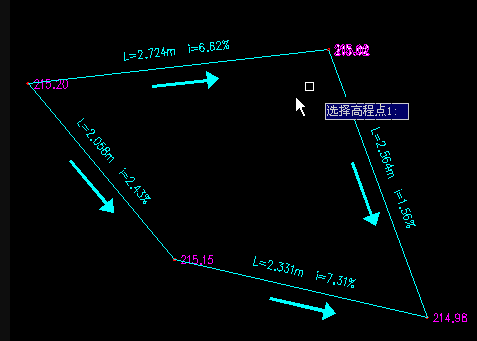

Help me draw slope polyline from 2 text, include: Length + %slope + Arrow?
Hello everyone.
I have two text, can anyone help me draw slope polyline like a picture when i selected text?
Edited by tuantrinhdp
Did you google using your key words it exists pick the 2 points, it may need some more options added.
This might get you started
;;; Program to obtain the slope between 2 points
;;; obtaining the length using only the x and y coordinates
;;; 20210914 By Isaac A.
;;; https://www.cadtutor.net/forum/topic/73702-help-me-draw-slope-polyline-from-2-text-include-length-slope-arrow/

2 hours ago, Isaac26a said:
Thank you so much.
Excuse me but can you edit help me, i want to select text, not pick?

Thank you so much.
Excuse me, can you edit help me, i want to select between 2 text, not pick?

(defun c:foo (/ 90d a ang len mpt off pts s2 siz ss txt vec wid _2p)
    (setq
        wid 10      ; arrow width
        siz 50      ; arrowhead width. Text offset from line is half of this.
        off (* 0.5 siz)
        90d (* pi 0.5)
        s2 (* siz 2)
    (defun _2p (p) (list (car p) (cadr p)))
    (while
        (cond
            (   (not (setq ss (ssget '((0 . "TEXT"))))) nil)
            (   (not (= (sslength ss) 2)) (princ "\nSelect only two texts."))
            (   (setq pts (mapcar '(lambda (a) (cdr (assoc 10 (entget (ssname ss a))))) '(0 1)))
                (if (> (caar pts) (caadr pts)) (setq pts (reverse pts)))
                (setq mpt (mapcar '/ (apply 'mapcar (cons '+ pts)) '(2.0 2.0 2.0))
                      vec (apply 'mapcar (cons '- pts))
                      ang (apply 'angle pts)
                      txt (list
                                '(0 . "TEXT")
                                (assoc 40 (entget (ssname ss 0)))
                                (cons 1
                                    (strcat
                                        "L=" (rtos (/ (apply 'distance pts) 1000) 2 3) "m, "
                                        "i=" (rtos (* 100 (/ (cadr vec) (car vec))) 2 3) "%"
                                (cons 7 (getvar "textstyle"))
                      len (textbox txt)
                      len (* 0.5 (- (caadr len) (caar len)))
                (entmake (append txt (list (cons 10 (polar (polar mpt (+ 90d ang) off) (+ ang pi) len)) (cons 50 ang))))
                (entmake (cons '(0 . "LINE") (mapcar 'cons '(10 11) pts)))
                (setq mpt (polar mpt (- ang 90d) (+ siz off)))
                (entmake
                    (list
                        '(0 . "LWPOLYLINE")
                        '(100 . "AcDbEntity")
                        '(100 . "AcDbPolyline")
                        '(90 . 3)
                        '(70 . 0)
                        (cons 10 (_2p (polar mpt (+ ang pi) len)))
                        (cons 40 wid)
                        (cons 41 wid)
                        '(42 . 0.0)
                        (cons 10 (_2p (polar mpt ang len)))
                        (cons 40 s2)
                        '(41 . 0.0)
                        '(42 . 0.0)
                        (cons 10 (_2p (polar mpt ang (+ len siz))))
                        '(40 . 0.0)
                        '(41 . 0.0)
                        '(42 . 0.0)
