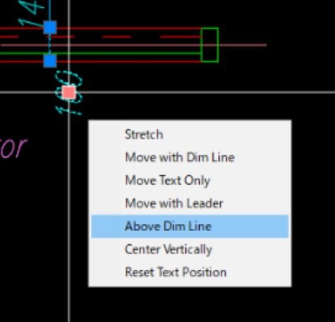

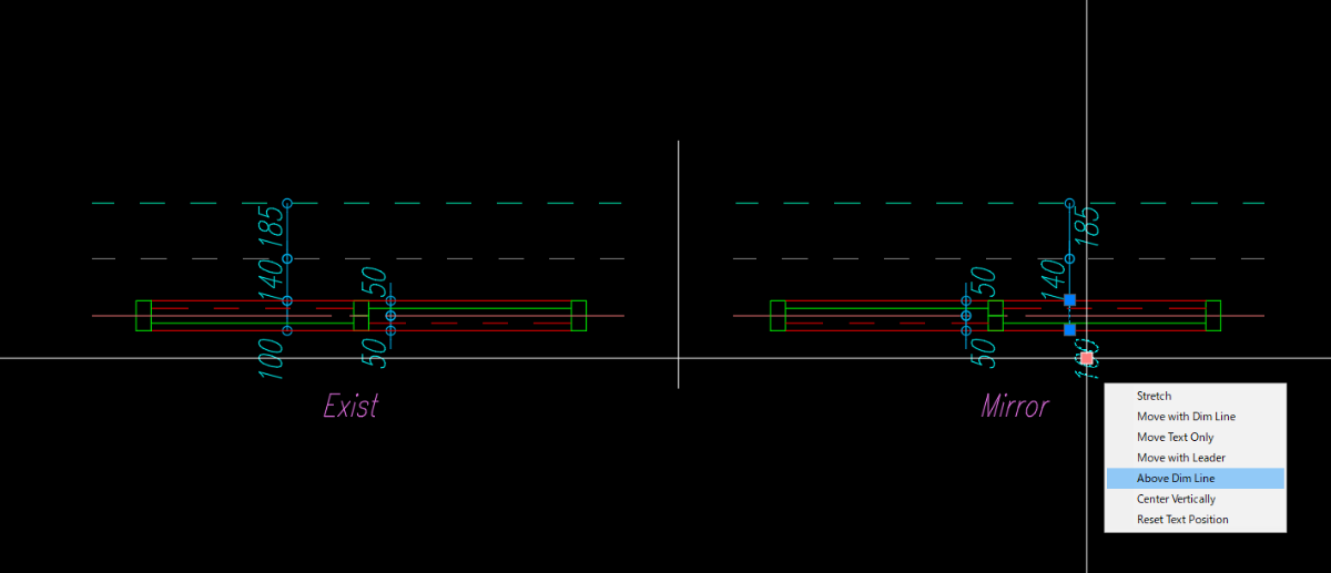

Adjustment Dimension'sText : "Above Dim Line" for selection
Hi!
Is there any way I can apply the command " Above Dim Line" to the dimensions I have selected!? Currently I am to tweak each one, after I made the Mirror command.
Thanks for all the help.Pictured is an example.

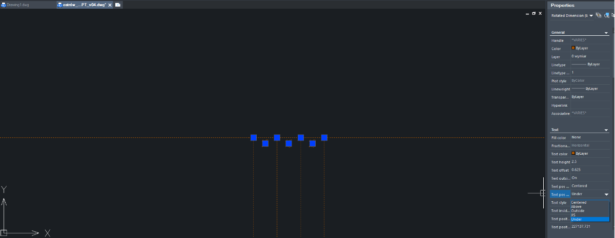

Hi Zwonko!
You can only edit the properties when the Text's postion is default ( At home). Once you've edited the Dim's text, the " pos hor, vert" entries will be disabled. Unfortunately your suggestion is not the solution.
Sorry, I'm not using autocad right now, and even don't have AC version that can do like You.
But i see that on the grip there is also option to reset text position. I think that after It should work, but I can't check. And maybe that isn't exacly what You looking for :)

Hi!
Since this example is quite simple, it's somewhat not clear what the problem is when the Dimension Line changes its position。I have large drawings with many overlapping horizontal and vertical dimensions. when changing "Dimension Text movement" according to your suggestion. Then I will have to reposition it again. In addition, it also changes the way Dim is expressed. Thanks for your suggestion

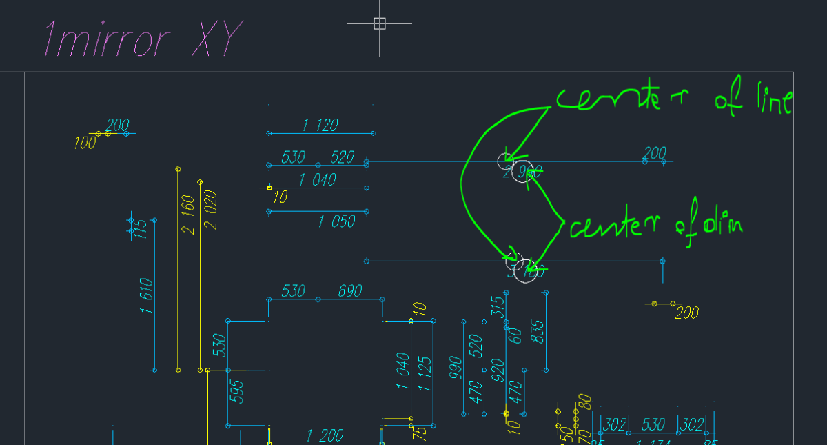

The problem was that i wasn't seeing Your fonts, must change it. The property "above" "under" was changing but the text real position not.
Modded the code which was working to check if dim is below line.
NOTE: there are still some dimensions for which the code is not working, but the orginal code which You gave also didn't. The problem is in dimensions, becouse the center of dimtext is not parpendicular to dimline center.
