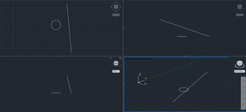

Ssget F works not based on whether the object is actually touching the object, but rather if you can actually "see" it touching the object in plain sight.
Here's an image of a circle and a line from four different views. From top-left clockwise: Top, Left, SE Isometric, Front. I've attached a dwg for you to try it out as well. You can clearly see that (geometrically) the line is not touching the circle at all. However in the SE Isometric, the line is (visually) crossing the circle just by "seeing" it. Doing ssget F on the two endpoints of a line on the top, left and front views will only get you the line, but do it in the SE Isometric view and you'll get the circle too. You can try it with this:
(ssget "_F" (list (getpoint) (getpoint)))
Therefore I would go about the approach that Trudy has taken. This one opts for single selection of curves instead.
