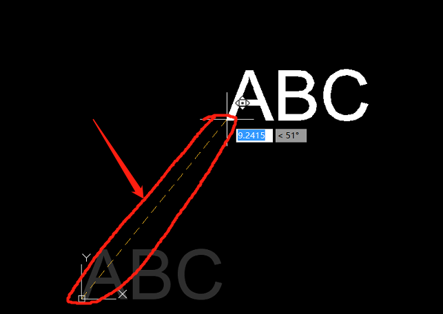

yxl030 Posted August 31, 2021 Posted August 31, 2021 Problem 1: I want to put some text,use "text" and "move" ( so that i can see what is being inserted.),then draw a line from the point I put to somewhere else. How to get the point in the command line? (defun c:test() (command "_.text" "0,0" 2 0 "ABC") (command "_.move" "_l" "" "0,0" pause) ; How to get this point I click ? Suppose it's Pt1 (command "_.line" Pt1 pause) ) Problem 2: Is there any way not to display this line when moving ? Quote

Steven P Posted August 31, 2021 Posted August 31, 2021 Try this after your move command so you can see your text as you move it about (setq pt1 (cdr (assoc 10 (entget(entlast)) ))) pt1 is the text coordinates. I've not seen how to hide that dashed line as you move things, is it a big problem or something that would be nice? If you can hide it, I guess it will be a system variable to change, type setvar and then ? to see a list of them, might be in there but I don't know 1 Quote

eldon Posted August 31, 2021 Posted August 31, 2021 For your problem 2, have you tried changing the colour of the rubber band line? Quote
yxl030 Posted September 1, 2021 Author Posted September 1, 2021 17 hours ago, Steven P said: Try this after your move command so you can see your text as you move it about (setq pt1 (cdr (assoc 10 (entget(entlast)) ))) pt1 is the text coordinates. I've not seen how to hide that dashed line as you move things, is it a big problem or something that would be nice? If you can hide it, I guess it will be a system variable to change, type setvar and then ? to see a list of them, might be in there but I don't know Thank you ,Steven P ! It works very well. I don't want it to display , just to make it look good. And I found out that this is no longer available. Quote

yxl030 Posted September 1, 2021 Author Posted September 1, 2021 (edited) Eldon, Thank you for telling me what it‘s called. Otherwise I wouldn't know that the problem couldn't be solved. https://knowledge.autodesk.com/support/autocad/learn-explore/caas/sfdcarticles/sfdcarticles/How-to-disable-or-change-the-color-of-the-rubber-band-in-AutoCAD.html the link is too old. Edited September 2, 2021 by yxl030 1 Quote
eldon Posted September 1, 2021 Posted September 1, 2021 12 hours ago, yxl030 said: Eldon, Thank you for telling me what it‘s called. Otherwise I wouldn't know that the problem couldn't be solved. https://knowledge.autodesk.com/support/autocad/learn-explore/caas/sfdcarticles/sfdcarticles/How-to-disable-or-change-the-color-of-the-rubber-band-in-AutoCAD.html Congratulations on finding that article. However it is dated 2015, and my research lead me to believe that from version 2018 and onwards, it was possible. So perhaps you should update!! 1 Quote
yxl030 Posted September 2, 2021 Author Posted September 2, 2021 (edited) eldon, Thank you for pointing out my mistake. chang it to black,It looks like gone Edited September 2, 2021 by yxl030 Quote
