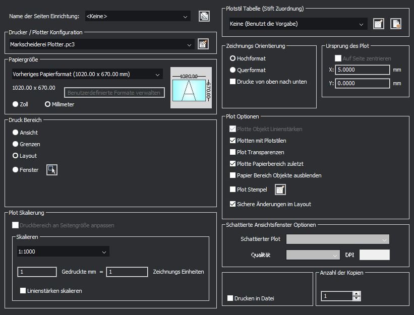

DennisFM Posted August 27, 2021 Share Posted August 27, 2021 Hello together, we are using BricsCAD Pro V20 on Windows 10 and as plotter HP DesignJet T830 MFP, when plotting maps directly from BricsCAD or also as exported as PDF we have sometimes the following errors: - the outer border of the map is not plotted completely, mostly the border which is on the side on which the plotter cut the paper is missing, sometimes all 4 borders. Thereby the plotter is not "cutting the border" there is still a gap but the border is missing. - on some plots text is missing, sometimes just some letters, sometimes complete words But these problems don't occur always, sometimes we plot the same plot twice, one is complete the second has one or both of the errors explained above. We updated the firmware and drivers but also if we switched the drivers, the problem still occurs. Does anybody have an idea what could be the cause for these problems? Cheers, Dennis Quote Link to comment Share on other sites More sharing options...

BIGAL Posted September 1, 2021 Share Posted September 1, 2021 You have hard clip limits set LL & UR I would use those with a Plot Window Center. This should work every time. inside your printer/plotter ie the actual printer not pc often the firmware limits can be set and an option can be to change margins, the firmware will override the plot output. 1 Quote Link to comment Share on other sites More sharing options...
DennisFM Posted September 2, 2021 Author Share Posted September 2, 2021 Thanks for your idea, at the moment I can't find a setting to change to a Plot Window Center, where can I find this option? Also I changed the margins but there is still the problem. Quote Link to comment Share on other sites More sharing options...
rkmcswain Posted September 2, 2021 Share Posted September 2, 2021 Is this is? 1 Quote Link to comment Share on other sites More sharing options...
DennisFM Posted September 2, 2021 Author Share Posted September 2, 2021 (edited) Oh yes, now I have it, I searched in the wrong setup. But I can't select it, it's grey and I can't select it. Edited September 2, 2021 by DennisFM Quote Link to comment Share on other sites More sharing options...
BIGAL Posted September 2, 2021 Share Posted September 2, 2021 (edited) Use Window and pick lower left and upper right then center. Google translate Fenster, Unten links, Oben rechts, Auf sete zentrum Edited September 2, 2021 by BIGAL Quote Link to comment Share on other sites More sharing options...
