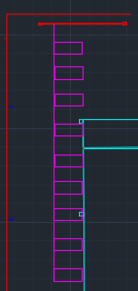

Casio47 Posted August 27, 2021 Share Posted August 27, 2021 Hello, I have 13 rectangles, all the same size, and all very closely lined up. I want to space all 13 rectangles 4' apart. Having troubles doing that. Thanks for the help Quote Link to comment Share on other sites More sharing options...
BIGAL Posted August 27, 2021 Share Posted August 27, 2021 So many questions and no answers, are the rectangles plines, all in a line, know the bottom edge size and so forth. Post at least an image. Quote Link to comment Share on other sites More sharing options...
Casio47 Posted August 27, 2021 Author Share Posted August 27, 2021 (edited) I have them lined up manually, did not snap to line Thanks for the help... Edited August 27, 2021 by Casio47 Quote Link to comment Share on other sites More sharing options...
CyberAngel Posted August 27, 2021 Share Posted August 27, 2021 Have you looked into the ARRAY command? That should do what you want. 1 Quote Link to comment Share on other sites More sharing options...

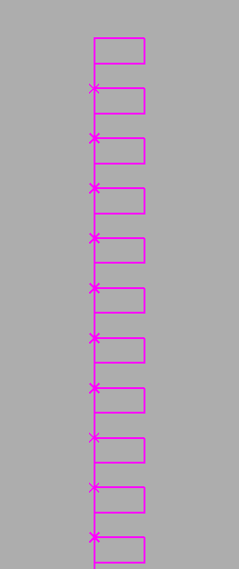

eldon Posted August 27, 2021 Share Posted August 27, 2021 There are so many different ways of spacing them, but I would start by using MEASURE to put points along your vertical line, and then moving the rectangles by snapping a corner to the mark. Quote Link to comment Share on other sites More sharing options...
BIGAL Posted August 27, 2021 Share Posted August 27, 2021 Even Copy Ortho on drag down with mouse and type in offset, 2*offset, 3*offset, 4 8 12 Quote Link to comment Share on other sites More sharing options...
