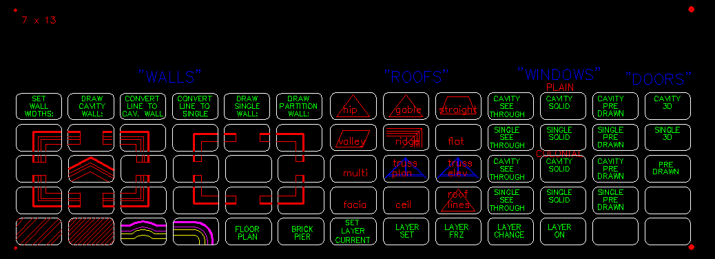

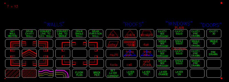

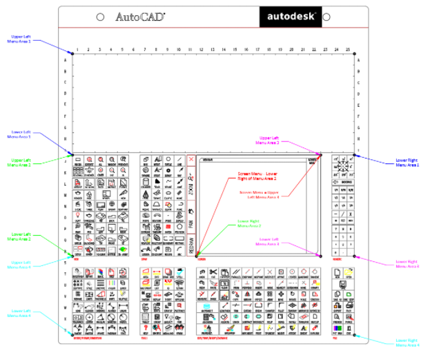

BIGAL Posted September 15, 2021 Posted September 15, 2021 (edited) Those of us old enough remember digitisers and all the commands you could put on them and a 4 button puck. There is a sample dwg somewhere, this is a panel for the digitiser. There are multi panels on the digitiser. Watching experienced users was super fast and they did not look at digitiser just knew where a command was. Edited September 15, 2021 by BIGAL Quote
