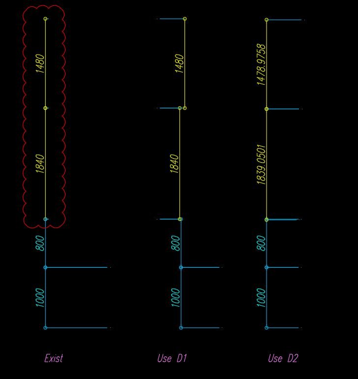

I have 2 problems when using the Dim edit lisp
1. I'm using this lisp to edit dim extension line. when working with dims without extension lines, it will cause dim to jump and change values. Is there any way to fix this problem of lisp(image attached and lisp "Dim Edit").

Problem one:

Thank you very much. I tried it and it works correctly. If possible, I hope to invite you to donate a cup of coffe 🙂
Forgive me, I have 2 unfulfilled points:
1. In the file Dim Edit.Lsp: also include lisp " stretch" Dim via select and pick point. I noticed it has the same problem and structure as Lisp "Extension Line". I tried fixing it, but unfortunately it doesn't work.
2. I don't know how to write lisp from the line of code you provided (Dim Hor-Ver selection). If you can provide lisp file or instructions to create lisp. That will help me a lot.
I have corrected my post above, I realised that before it also selected aligned dimensions that resulted in a 0° angle. Now it selects rotated dimensions with a rotation angle of 0° or 90°, because horizontal and vertical dimensions are special types of rotated dimensions.

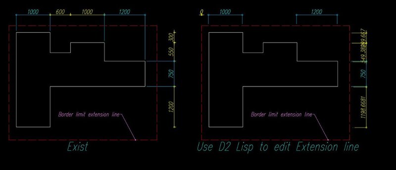

Perhaps you took it the other way around what I meant at the beginning. Point 2: in the topic is another lisp, I just want to quickly select linear dims (horizontal, vertical, diagonal...).

Diagonal at what angle? 45°? I could implement the selection by adding the 45° angle.
Can I select a Dimension and the lisp will select the Dimensions in its linear?
On 8/30/2021 at 10:40 PM, confutatis said:
Excuse me, but I don't think I understand. The selection in the program selects the horizontal and vertical dimensions. If you also want to select diagonals, what angle of rotation do they have to be? Can I have diagonals at 30°, 45°, 60°, etc.?
Sorry for taking up so much of your time. English is not my native language.
I will try to explain with Attachment.
Example: Slope park ramp- it has no specific angle. Maybe I shouldn't have mentioned the diagonal in the description. Instead I want to select Dims that are on the same route (just like creat dimension using the Dim continue command).
Can you separate this Lisp from the "Extension line" Lisp? Because choosing dim also helps me perform other editing operations.
Looking forward to your help.Thanks
P/s: I also attached a lisp which helps me to resize the Extension line by entering the value. It also has problems with Dims that don't have an Extension line.
