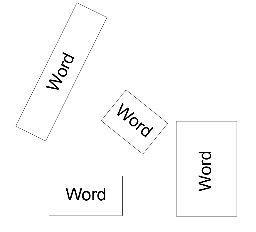

Can someone write a lisp for me?
To add a word in the middle of all the rectangles  selected.
Same font size,like the jpg.
Thanks.

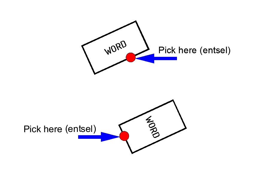

Great routine, BIGAL. May I ask you to modify the code so that the text is rotated not according to the longest border of the rectangle, but according to the border picked by (entsel) method? Like the picture below.
When you select a pline you can get which segment did you pick via code. The answer is in label a chamfer I think it was here a few days ago.
