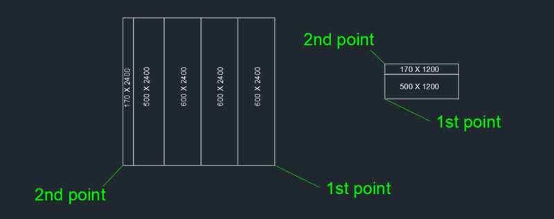

Halsy Posted August 21, 2021 Share Posted August 21, 2021 i have to draw fixed width rectangle which is 600,500,450,400,360,350,320,300,280,275,270,260,250,230,225,220,210,200,195,190,185,180,175,170,165,155,150,145,140,135,130,125,120,115,110,105,100 and between two selected point whether on axis or y axis Quote Link to comment Share on other sites More sharing options...

Halsy Posted August 22, 2021 Author Share Posted August 22, 2021 if i select 2 point which is shown in image then rectangle of fixed with which is emption early has to come and after selection user has to give height of that rectangle which is on both x axis and y axis Quote Link to comment Share on other sites More sharing options...
devitg Posted August 23, 2021 Share Posted August 23, 2021 Sad to say , ACAD can not edit a image. Please up load your DWG - Other fact what could be the distance from point-1 to point-2? How it will be discriminated or decided which measure to take The horizontal have 3 x 600 + 1 x 500 + 1x 170 . Or could it be 2 x 600 + 2 x 300 + 1x250+ +1x120+ 1x130+ 1 x 170 Please set up the formation rule. Quote Link to comment Share on other sites More sharing options...
BIGAL Posted August 23, 2021 Share Posted August 23, 2021 This has been discused in great length over at forums/autodesk and I think is posted here now as there ws not a final solution provided. The issue with the solution was the random way a final panel is chosen it was like I want an answer from the 5 different combinations that I could use but the code has to pick the correct one which seems totally random. Again look at this before replying https://forums.autodesk.com/t5/visual-lisp-autolisp-and-general/divding-two-points-into-specifi-width-and-height-of-rectangle/td-p/10533944/page/2 its up to 24 replys. Quote Link to comment Share on other sites More sharing options...
Halsy Posted August 23, 2021 Author Share Posted August 23, 2021 if i select 1st point and 2nd point on screen then user has to give a height of that rectangle then rectangle of width 600 ,500,450,400,360,350,320,300,280,275,270,260,250,230,220,210,200,195,190,185,180,175,,170,165,160,155,150,145,140,135,130,125,120,115,110,105,100 has to come where maximum number of rectangle of width 600 has to come then rest of above list Drawing1.dwg Quote Link to comment Share on other sites More sharing options...
Halsy Posted August 23, 2021 Author Share Posted August 23, 2021 where the length is taken between two selected points Quote Link to comment Share on other sites More sharing options...
devitg Posted August 23, 2021 Share Posted August 23, 2021 so the distance between 2 point can always hold the sizes show , only will end to 5 or 0 ? Quote Link to comment Share on other sites More sharing options...
Halsy Posted August 23, 2021 Author Share Posted August 23, 2021 The distant between 2 points may be end with 0 or 5 Quote Link to comment Share on other sites More sharing options...
