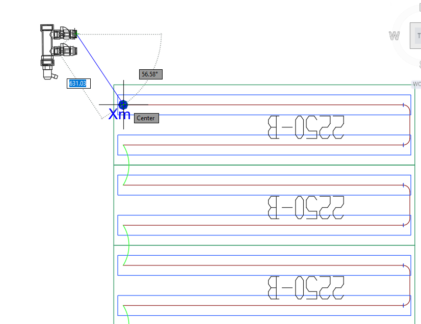

sofiane Posted August 20, 2021 Share Posted August 20, 2021 (edited) Hello everyone, I really need a lisp please, to write the length of a line, when a draw it, add 1m and round up, When i draw the blue line, where there "XM" i need the length of the line so here 631mm and add 1000m so total 1631mm. But I want to round up, so i want to write here 2m Can someone help me please Thanks Edited August 20, 2021 by sofiane Quote Link to comment Share on other sites More sharing options...
devitg Posted August 20, 2021 Share Posted August 20, 2021 Please upload your sample dwg , and where you want the length of the line to be seen Quote Link to comment Share on other sites More sharing options...
BIGAL Posted August 21, 2021 Share Posted August 21, 2021 (edited) As a start, very rough. Like devitg need dwg. (defun c:d1-2 ( / p1 p2 d) (setq p1 (getpoint "\nPick point 1 ") p2 (getpoint "\nPick point 2 ") ) (command "line" p1 p2 "") (setq d (/ (+ 1000.0 (distance p1 p2)) 1000.0)) (setq intd (fix d)) (setq frac (- d (fix d))) (if (< frac 0.5) (progn (setq frac 0.5) (setq d (+ intd frac)) ) ) (setq txt (rtos d 2 0)) (setq p1 (getpoint "\nPick point for text ")) (command "text" p1 "50" "0" (rtos d 2 0)) (princ) ) (c:d1-2) Edited August 21, 2021 by BIGAL Quote Link to comment Share on other sites More sharing options...

sofiane Posted August 23, 2021 Author Share Posted August 23, 2021 On 8/21/2021 at 4:36 AM, BIGAL said: As a start, very rough. Like devitg need dwg. (defun c:d1-2 ( / p1 p2 d) (setq p1 (getpoint "\nPick point 1 ") p2 (getpoint "\nPick point 2 ") ) (command "line" p1 p2 "") (setq d (/ (+ 1000.0 (distance p1 p2)) 1000.0)) (setq intd (fix d)) (setq frac (- d (fix d))) (if (< frac 0.5) (progn (setq frac 0.5) (setq d (+ intd frac)) ) ) (setq txt (rtos d 2 0)) (setq p1 (getpoint "\nPick point for text ")) (command "text" p1 "50" "0" (rtos d 2 0)) (princ) ) (c:d1-2) HI Bigal thanks for your code, i tried it and i think it's working no ?? Can we add "m" for meter at the end of the text please ? Do you see another amelioration ? Thanks a lot ! Quote Link to comment Share on other sites More sharing options...

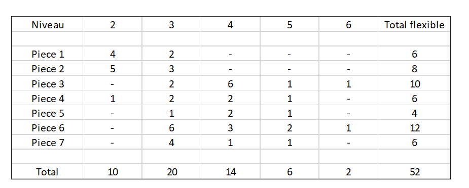

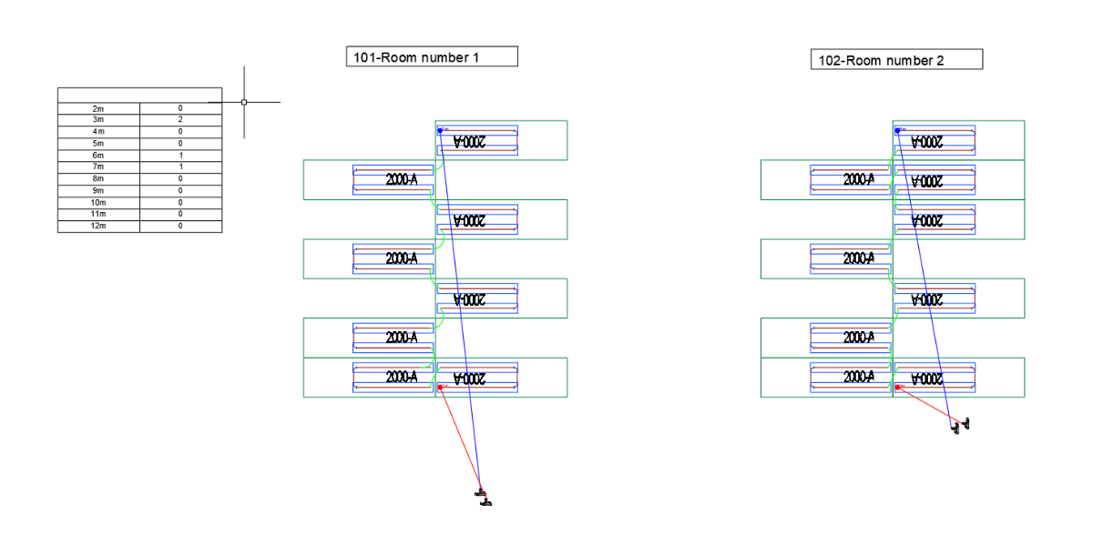

sofiane Posted August 23, 2021 Author Share Posted August 23, 2021 29 minutes ago, devitg said: put text on a dedicated layer . then do a ssget an ssget ? Imagine that I have several lines drawn. A hundred for example. Each line has a text, with "its length". The one I asked for, that is with 1 meter and rounded up. Normally my lines never exceed 12 meters. My wish is to have a table next to it, 2 columns, 13 lines (corresponding to the lengths from 2 to 12 m). The idea is to indicate directly, the number of lines 3m, 4m etc... that I have. a lisp that counts directly. Quote Link to comment Share on other sites More sharing options...

sofiane Posted August 24, 2021 Author Share Posted August 24, 2021 11 hours ago, BIGAL said: Devitg is correct put the text on 1 layer so you would use something like this. (setq ss "X" (list (cons 0 "TEXT")(cons 8 "Mylayername")(cons 410 (getvar 'ctab)))) so now have all the text objects would make a list of all the length ((2)(3)(4)(2)(2)(3)............ Then sort them ((2)(2)(2)(2)(3)(3)(4)(4)..... Then do a count of matching objects ((2 4)(3 2)(4 2)........... Put in table All done Need to think about it. Something confusing Units is set to feet but exemple is 685 long is this mm so want length in metres ? 0.685 round to 2. Yes, i'm working in mm and want after a txt in meter. Your code to draw a line and have a txt with meter is working great. Like i said, i need another part. I want a table, by piece, with number flexible Here an example of my plan I draw all the line with the lisp. Know i want a table like this I'm making it manually right now, but i want to save time, and make it automatically we'll be great ! Quote Link to comment Share on other sites More sharing options...
