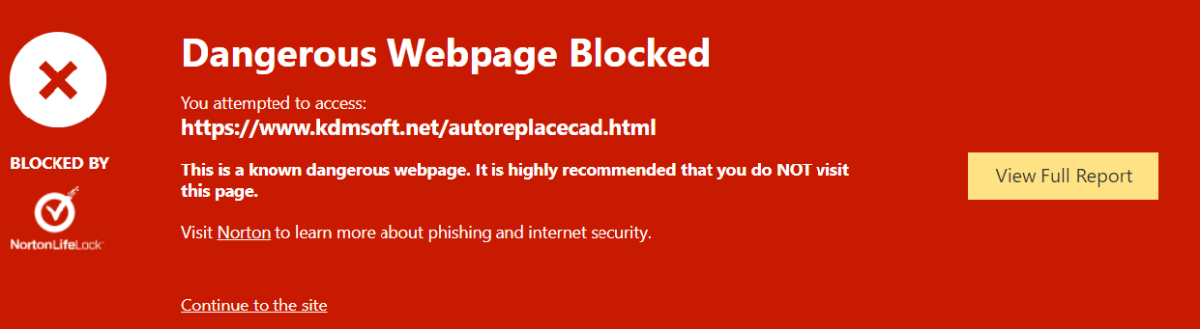

Hi Maratovich, I often recommend your programs thought I would let you know my Norton Virus check reports this.
Also look at Ish community rating -19 wants everything for free and some one else do it.
Thanks BIGAL. I have known about this for 5 years.
I have corresponded with the Norton developers.
They said that in Norton there is only a white and black list, and to determine viruses, you need to send a file to their technical support.
And if the file is not in the whitelist, it will always be shown as a virus. You need to manually add files to the white list on your computer.
You can submit files to Norton's website for verification. They will confirm that the file is clean, but will not add to the whitelist.
Considering that there are many programs and they constantly have new versions - they are not on the white list.
In my opinion (I got the impression) that I was offered to become their sponsor, but I don't want to.
Any other antivirus shows - clean.
