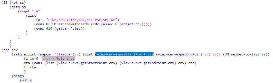

Jonathan Handojo Posted August 13, 2021 Share Posted August 13, 2021 Hi all, I seem to stumble into a little problem here... This image below is returned from a "Break On Error", and the error message returned is "Error: bad argument value: AcDbCurve 667". My function JH:selset-to-list is the equivalent to LM:ss->ent in Selection Set to List. I inspected the variable 'cr' and it returns an entity name. (And for some reason I can't open the watch window). I really now don't know what else is the issue. Does anyone ever encounter this problem? Sometimes the program works and sometimes it doesn't. Thanks, Jonathan Handojo Quote Link to comment Share on other sites More sharing options...

ronjonp Posted August 13, 2021 Share Posted August 13, 2021 It's crashing on a PolyFaceMesh object: ((-1 . <Entity name: 27fb44990b0>) (0 . "POLYLINE") (330 . <Entity name: 27fb8a289f0>) (5 . "B5EDB") (100 . "AcDbEntity") (67 . 0) (410 . "Model") (8 . "H-SEW-NE") (100 . "AcDbPolyFaceMesh") (66 . 1) (10 0.0 0.0 0.0) (70 . 64) (40 . 0.0) (41 . 0.0) (210 0.0 0.0 1.0) (71 . 2) (72 . 0) (73 . 0) (74 . 0) (75 . 0) ) 1 Quote Link to comment Share on other sites More sharing options...
