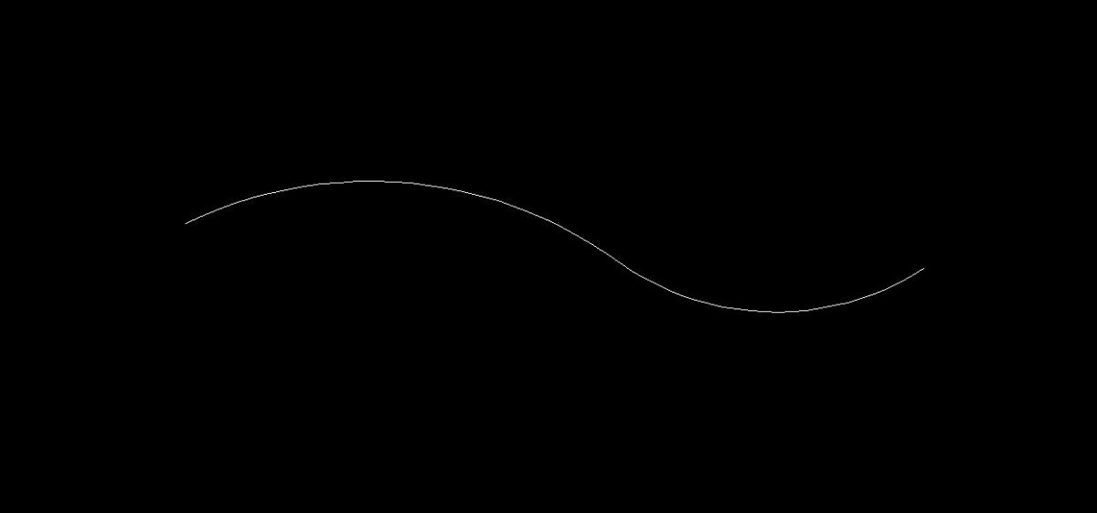

Isaac26a Posted August 12, 2021 Posted August 12, 2021 Hi friends, I have this small code to select lines or polylines and obtain the length, but it sometimes gives me this error. Cannot calculate the area of a self intersecting curve. The code is the following: (setq poly (car (entsel "\nSelect the polyline\n"))) (setq long nil) (vl-cmdf "_.area" "_e" poly) (setq long (getvar "perimeter")) Do you know a better way to avoid this error. Quote

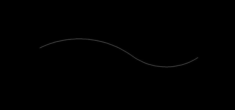

devitg Posted August 12, 2021 Posted August 12, 2021 (edited) Use the VLA-get-length obj (VL-LOAD-COM) (SETQ POLY (CAR (ENTSEL "\nSelect the polyline\n"))) (SETQ POLY-OBJ (VLAX-ENAME->VLA-OBJECT POLY)) (SETQ LONG (VLA-GET-LENGTH POLY-OBJ)) I did for this poly Edited August 12, 2021 by devitg add img 1 Quote
Isaac26a Posted August 12, 2021 Author Posted August 12, 2021 28 minutes ago, devitg said: Use the VLA-get-length obj (VL-LOAD-COM) (SETQ POLY (CAR (ENTSEL "\nSelect the polyline\n"))) (SETQ POLY-OBJ (VLAX-ENAME->VLA-OBJECT POLY)) (SETQ LONG (VLA-GET-LENGTH POLY-OBJ)) Thanks devitg you solved a problem I've been carring for a long time, do you have also a command for the area, that also gives me the same answer. my guess would be vla-get-area but I don't have any reference of vla commands. My problem was with the polyline made of 2 curves (I actually don't see any self-intersecting curve) but that´s what it is. Do you know if Autodesk has a new pdf of the vla and visual lisp commands as they used to have? because in my really old version the vla-get-lenght doesn't come Quote

devitg Posted August 12, 2021 Posted August 12, 2021 Also you can use (vlax-curve-getArea curve-obj) Quote
Isaac26a Posted August 12, 2021 Author Posted August 12, 2021 2 minutes ago, devitg said: Did you test the lisp? Yes, and works pretty fine, thanks. Quote
