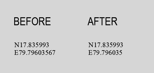

I have 8digits after decimal and I want to change it in 6 digit after decimal is there any way to do this
this will display the 6 digits x will still have 8

those are mtext format the command you suggest not working
Hi @pmadhwal7, please explain from where this mtext comes from .
It seem to be some like a surveyor dwg.
And made  from a LISP or other api used .
The only way I see to do it,  is EDIT by LISP   all    MTEXT and change as need to be with a LISP routine .
Please upload a new DWG with a few more mtext
I will try to fix it by a LISP.

How can I change all this MTEXT from 8 decimal to 6 decimal ?
Please find dwg attached

Hi @pmadhwal7. please give it a test

(DEFUN C:8-6  ()
  (8-TO-6-DECIMAL)
  (PRINC)
  Type 8-6 at command line
8-to-6-decimal.LSPFetching info...

Anyway, quick and cheerful and with minimal testing and checking (it is Sunday and dinner time too). Quick happy for comments and improvements of course
(defun c:8-6DP ( / myent mytext 6dp eastings northings 6dptext)
;; Select Text
  (setq myent (entget (car (entsel "Select Text: "))))
  (setq mytext (cdr (assoc 1 myent)))
;;Length of First line coordinate
  (setq 6dp (+ (vl-string-position (ascii ".") mytext) 7) )
;;First line coordinate
  (setq eastings (substr mytext 1 6dp))
;;Second line of text
  (setq mytext (substr mytext ( + (vl-string-search "\\P" mytext) 3)))
;;Second line coordinate
  (setq northings (substr mytext 1 6dp))
;;Text joined together
  (setq 6dptext (strcat eastings "\\P" northings))
;;put back into mtext
  (setq myent (subst (cons 1 6dptext) (assoc 1 myent) myent))
  (entmod myent)
  (entupd myent)

thnks all for ur help problem slove
