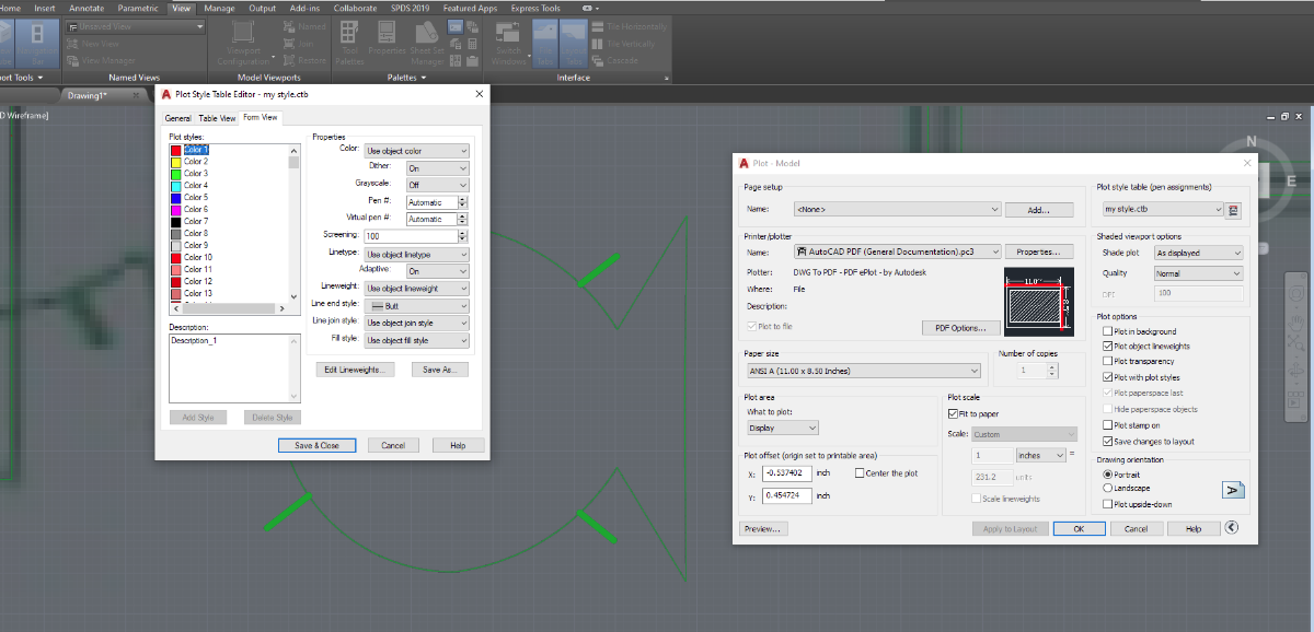

Hi, I have a problem that seems really easy (need to make line ends square) to solve but i tried multiple solutions and it doesn't work. I dont have a box called "display plot styles" that every solution recommends to check and I have "plot paperspace last" greyed out. I saw some solutions connected to it and i cant change it. Do you have any suggestions on how to work around it? Down below is a screenshot of my settings. I'm working in AutoCAD 2019. Also if i plot it, the final result has the edges squared just like i want to see  in viewport. The paper space have them round like in the viewport.
You have the box called "Plot with plot styles" checked which is unrelated.
Edit your "my style.ctb" click the [Form View] tab up top and modify the settings for "Line end style:" and "Line join style:"
Edit: You have to select the plot styles you want to modify first.
Edited by tombu
