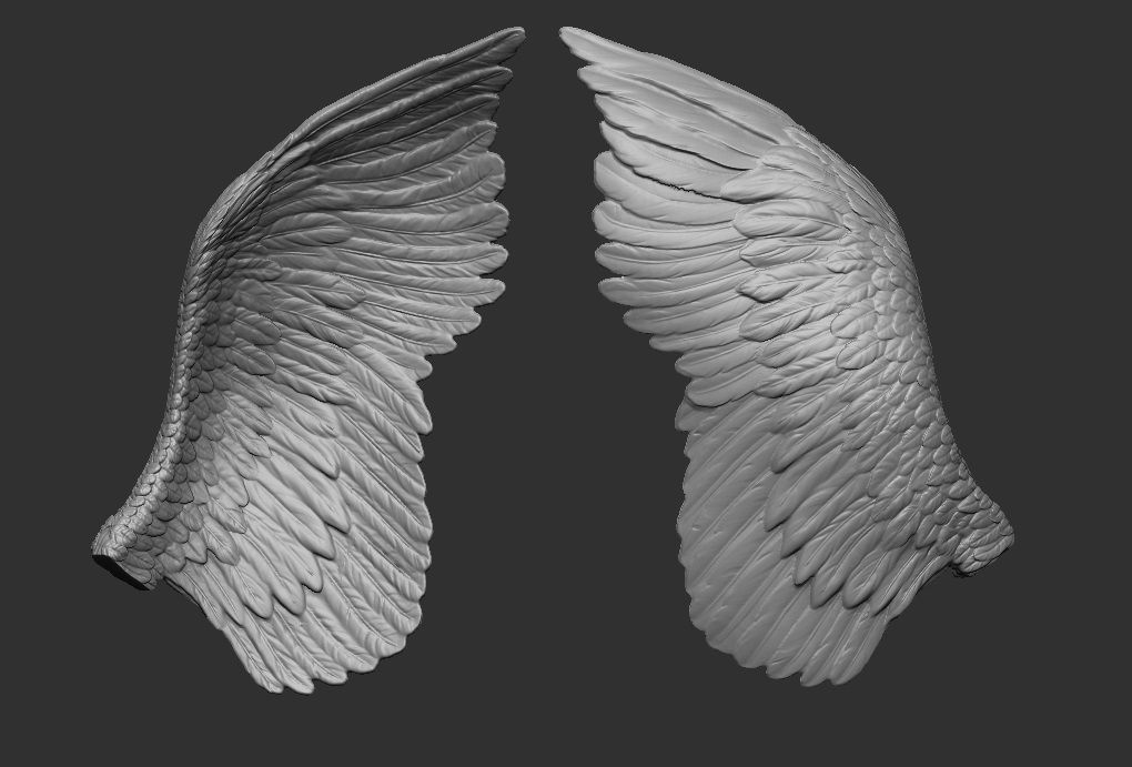

Cad64 Posted August 10, 2021 Posted August 10, 2021 Yeah, Zbrush has a pretty steep learning curve. It's not the type of program that you can just jump in and start working. It takes a lot of time and practice to become even somewhat proficient with it. If you're going to 3D print this model, why bother with all the individual feathers? It seems like you would be better off creating the entire wing and then sculpt in the detail. Something like the attached image. Not my work, but it shows the basic idea. I'm a little out of my realm with this though, since I've never done any 3D printing. Maybe someone else will have some suggestions. Quote
MacK33 Posted August 11, 2021 Author Posted August 11, 2021 Yeah it does have a very steep learning curve plus I think I would need the full version to do what I want to. I could try making the wing then sculpting as you say but I'm trying to get a higher level of detail than you can see on those wings. With the vanes of the feathers and cut outs in them. Also it would take me a very long time to master sculpting to get anywhere near that standard. Quote
