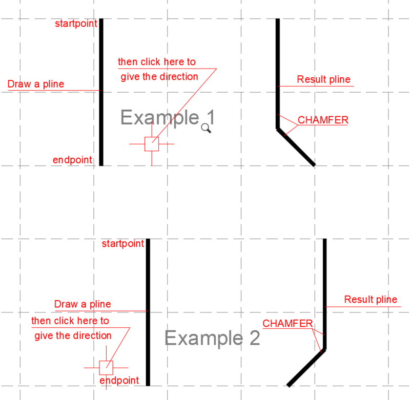

can anyone help me to make all my exiting polylines to end fillet of 45 degree

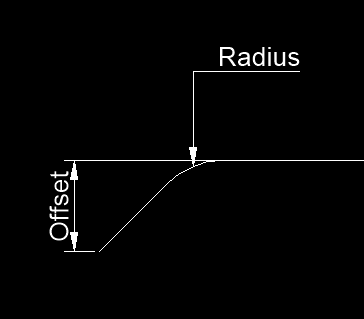

I have tried to modify BIGAL‘s Lisp,It basically meets my requirements.
(defun C:45dpline ( / oldsnap pt1 pt2 pt3 pt4 pt5 dire off rad ent)
(setvar 'osmode 0)
(setq off 180.0 rad 0.0)  ;
(setvar 'filletrad rad)
(setq dire (getstring "\n Clockwise(Y/n): "))
(while (setq ent (entsel "\npick p/line near end Enter to exit"))
;(setq pt3 (cadr ent))
(setq obj (vlax-ename->vla-object (car ent)))
(setq pt1 (vlax-curve-getStartPoint obj))
(setq pt2 (vlax-curve-getEndPoint obj))
(setq ang (angle pt1 pt2))
(setq pt4 (polar pt2 (- ang (/ pi 2.0)) off))
(setq pt5 (polar pt4 (+ ang (* pi 0.75)) off))
(if (= dire "n")
    (setq pt4 (polar pt2 (+ ang (/ pi 2.0)) off))
    (setq pt5 (polar pt4 (- ang (* pi 0.75)) off))
(command "line" pt4 pt5 "")
(setq pt5 (mapcar '* (mapcar '+ pt4 pt5) '(0.5 0.5)))4
(command "fillet" ent pt5)
(setvar 'osmode oldsnap)

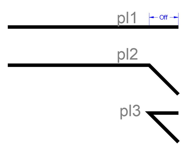

But when I click on the OFF part on the pline, it will bends like pl3,I don't understand why this happens.
How to avoid this ?   I hope No matter where I click to select ,it bends like pl2.
