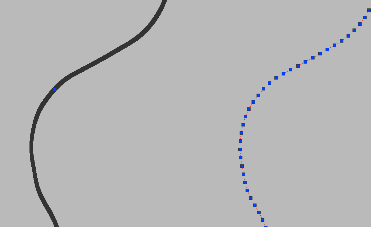

But you could manipulate the data in the spreadsheet. There are about 76000 coordinates. I took every one hundreth coordinate and then plotted them as a polyline. The picture shows them with grips activated.
Like Eldon dump the excel to a csv and just read every 100th point that would be a lisp answer. In excel would write a script file, then load in Autocad, need a vba answer maybe that is what Eldon did. You could save the macro as a txt file and copy and paste into a macro when required.

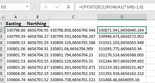

thank you Eldon and Bigal, i used this formula found here, which picks every N points, so i set to 100
=OFFSET($C2,(ROW(A1)*100)-1,0)

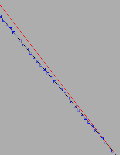

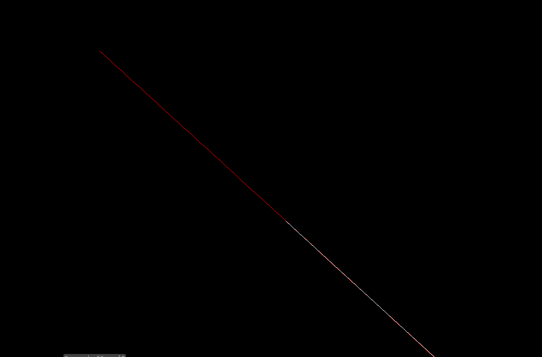

the result is that the first 70 meters are omitted... so the white line is the reduced one.... of course i dont want this

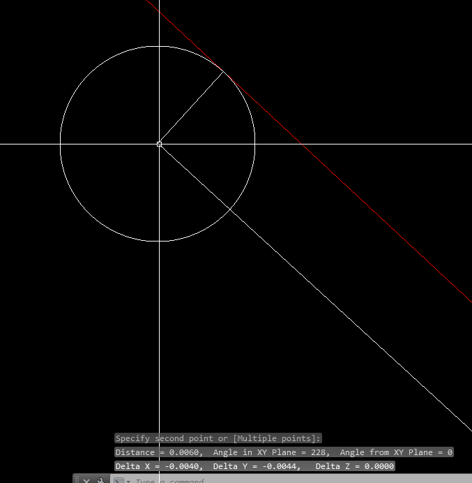

also, the lines get offsetted even if for a super tiny distance

In your data, each line is about 1 unit. If you take any points away, you are bound to get slight gaps from what was there before. You are going to decide what your tolerance is, then you can reduce the number of lines to suit. I thought that OVERKILL only worked on overlapping lines, and there are none here.
I use Excel in a simple fashion, but it can process data very powerfully and I am learning every time I use it. In this case I first of all saved the data in CSV format (I could not see any data when I opened the file). Then I used three new columns. I set up a counter =(C1+1), then I set up a condition =IF (MOD(C3,100),A3,0) in column D and a similar one in column E. Then I highlighted those three cells, went down to the bottom of the data, highlighted the same three columns and pressed Control D and the columns were filled and every 100th row had Easting and Northing and the rest were filled with zeroes. I then manually copied over the easting and northing on the first and last lines. I then saved as CSV, opened the file, deleted the first three columns, and then used the Excel facility to delete duplicate data which got rid of all the rows with zeroes except the first one which I manually deleted. I was then left with a deleted file with 770 points. I opened Autocad and started the polyline command. I opened the data file in WordPad, selected all and copied, and then in AutocAD copied the data into the command line. Polyline drawn in a trice!!
But the new polyline will only coincide with the old one at every hundredth point.

I finally managed to get an equation or two to work in Excel, and if you take every hundredth point for a new line, the maximum offset from the original polyline is 3.85 to the right and 2.90 to the left.
