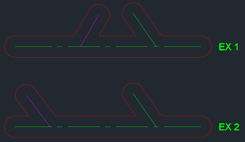

I am creating a program to generate mill slots and to update (using reactors) if a centerline is modified.  The only thing I can't figure out is how to handle the reactors for the secondary entities linked to the one being modified.
I am currently approaching the problem like so:
Each centerline has xdata that contains the handle of the outline followed by the handles of the other linked centerlines.
When the magenta line is modified, the outline will be deleted and a new outline will be generated based on the linked items, but that means a new handle needs to be added to the two other lines.  (I will have a similar and more complex problem when a new line crosses/interacts with the polylines)  I've tried modifying xdata once before and it ended up stuck in a loop.  I thought that by modifying the xdata my object modified reactor would trigger but it didn't seem to.
I don't have any working code ready to post yet, but what I really could use is some advice or guidance on the logic to trigger my reactors on secondary objects.

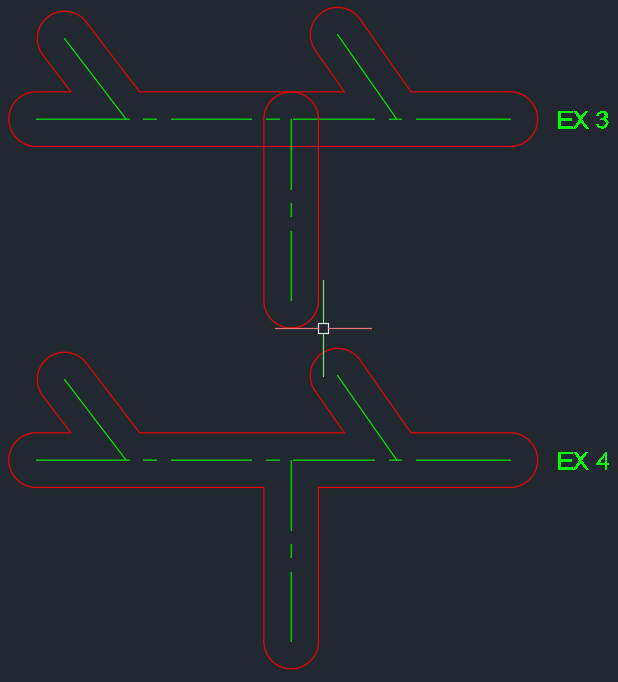

The real challenge happens when I create another slot though.  Initially a new slot--the vertical one in EX 3 (I forgot to color it)--would be created, but the reactor would need to trigger and combine the new slot with the slot that it crosses (EX 4).

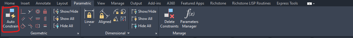

When you're done, use the AUTOCONSTRAINT command (or optionally go here).
Go to Settings first, check the Coincident, Parallel, Tangent and Concentric while leaving the rest unchecked:
Click OK and select the whole red and white curves and enter.
Now you can move the white lines and the red ones will follow.

These are vacuum feed slots for extrusion dies and I draw 20 - 30 unique slots per die.  I am essentially trying to create a closed multi-polyline that updates when centerlines are moved or when a new line intersects with a previous line.  I can't seem to figure out how to trigger the reactor for polylines that are not currently part of the profiles xdata.  I really appreciate everyone's help, but I really think reactors are key to this.
