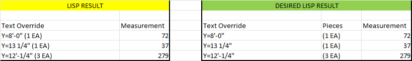

Hi!
This lisp works amazing, I came up with a similar problem though.
We override several dimensions for productivity purposes. The fact is that all of those dimensions shares a format. The format is:
FAB: Y=nn'-mm" (xx EA)
The nn'-mm" & xx varies per each overridden dimension. Is it possible to extract only the information between the parenthesis?
I have attached a snip.
Thanks in advance!
Try this one,
