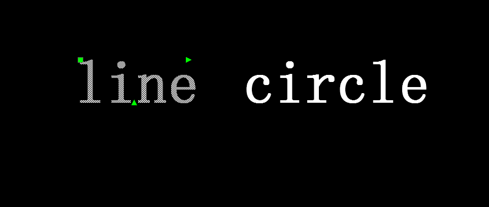

When I select a certain text, I automatically get the text closest to its position?
You can write your routine as follows:
1- Select main text object.
2- Select all texts by function ssget "_X" or better to ask the user to select all around texts to shorten the iteration process.
3- Iterate through the selection set and retrieve the insertion point of texts along with the entity_name and assign them to a list.
4- Sort the list based on shortest distance between the firstly selected text and ones in the list.
5- Finally highlight the first element that is in the sorted list since it is the closest one to text.
Turn the bulb up then you will find it somehow easy to do if you have basics of lisp programming at least. :)
Yes, I am new to lisp. According to the ideas you provided, I think the fourth point is about sorting, which is currently difficult for me to do. Thank you, sir

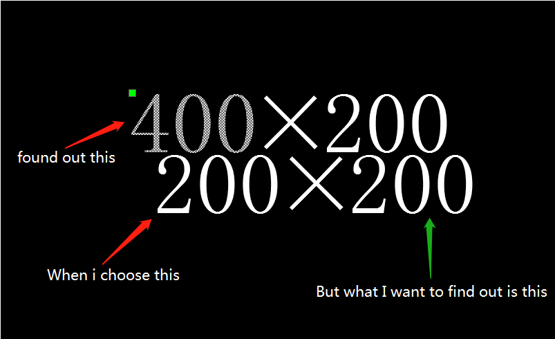

I cannot Iterate through the selection set, and sort. So I assume a point, is to expand the x and y coordinates of the text to define the reference point. It succeeded, but this is not the effect I want. You can help my brother。
When I click, what I get is that the most recent text is the above one. But I need to get the number to the right of ×

Here is my approach to get the second text that is close to the main selected text.

Here is a new one with a few mods for a better performance and alert.

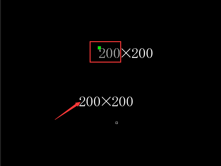

Hello, there is a question that needs your help. I used my own code to get the nearby text, but in some cases, the obtained is not what I want. How can I modify my code to meet the requirements.
Looks like 400 will always be closest to 200. If its that close why not just select the 200 you want with your mouse or is this a part of a bigger lisp to update text?
You may have to rework the approach using SSGET "F" this would use say 1st text then look say to the right a fixed distance so would not find a text with a different Y, another is a "CP" where you draw a extended  box around the text's and look at the Y value again with a Fuzz factor/tolerance.
