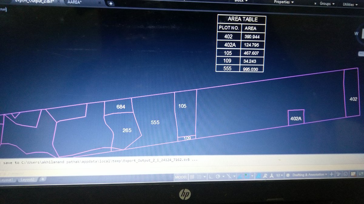

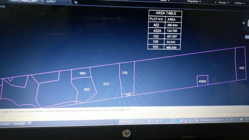

Ish Posted July 25, 2021 Share Posted July 25, 2021 (edited) Dear members, Any lisp program or trick to make a area table From a plan. I want a area table with plot number text along with area . I will select all at time, the automatically generate area table. Please See the attached image. AREA TABLE OF POLYGON.dwg Edited July 26, 2021 by Ish Modified again Quote Link to comment Share on other sites More sharing options...

Ish Posted July 25, 2021 Author Share Posted July 25, 2021 But sir I need plot number also, According leemac only area is coming.and I think we have to pick or select one by one also. I need plot number text and area of that plot. Quote Link to comment Share on other sites More sharing options...
Ish Posted July 25, 2021 Author Share Posted July 25, 2021 3 hours ago, Ajmal said: dear Ish, I think you will be satisfied with our master lee mac program. http://www.lee-mac.com/arealabel.html I used but not fullfil my requirements. It is providing only area , I need also plot number text. Quote Link to comment Share on other sites More sharing options...
confutatis Posted July 25, 2021 Share Posted July 25, 2021 One question: where is the area derived from? 1 Quote Link to comment Share on other sites More sharing options...
Ish Posted July 25, 2021 Author Share Posted July 25, 2021 Every plot have close polyline ( boundary). Quote Link to comment Share on other sites More sharing options...

Steven P Posted July 25, 2021 Share Posted July 25, 2021 So this will get the text written in the rectangles, assuming they are polylines. Largely untested though, it is Sunday. See the 'princ' at the end for where the text is. After that you could modify Lee Macs LISP to add these names in, good luck to that, I have never been very successful in working out how he does things. (defun c:txtinrect( / mytext myrectss acount) https://forums.autodesk.com/t5/visual-lisp-autolisp-and-general/get-xy-coordinates-of-2d-rectangle-lwpolyline/td-p/846832 (defun massoc (key alist / x nlist) (foreach x alist (if (eq key (car x)) (setq nlist (cons (cdr x) nlist)) ) ) (reverse nlist) ) ;end ;;get rectangles (setq myrectsss (ssget '((0 . "LWPOLYLINE")))) (setq acount 0) (while (< acount (sslength myrectsss)) (setq mycoords (massoc 10 (entget (ssname myrectsss acount)))) (setq pt1 (nth 0 mycoords)) (setq pt2 (nth 2 mycoords)) (setq mytext (ssname (ssget "_W" pt1 pt2 '((0 . "*text"))) 0)) (princ (vla-get-textstring (vlax-ename->vla-object mytext))) ;;each text withn a rectangle (setq acount (+ 1 acount)) ) ) you could also look at this to get the area of a rectangle using pt1 and pt2 above, and then just find a lisp to create a table using these... it is Sunday though, TV to watch.... Quote Link to comment Share on other sites More sharing options...

Ish Posted July 26, 2021 Author Share Posted July 26, 2021 (edited) The attached image just for example, In main file there no rectangular shape, Each shape are different . Like a polygon, that's why pick point aur corner to corner selection will not be a solution. Thanks AREA TABLE OF POLYGON.dwg Edited July 26, 2021 by Ish Modified Quote Link to comment Share on other sites More sharing options...

confutatis Posted July 26, 2021 Share Posted July 26, 2021 (edited) (defun C:ADDTAB (/ ss lista2d arealist index ename listpoint pointtable objtable) (if (not (setq ss (ssget '((0 . "LWPOLYLINE")(8 . "BOUNDARY"))))) (vl-exit-with-error "") ) (defun lista2d (lst) (if lst (cons (list (car lst) (cadr lst)) (lista2d (cddr lst)) ) ) ) (setq arealist '()) (repeat (setq index (sslength ss)) (setq ename (ssname ss (setq index (1- index)))) (setq listpoint (lista2d (safearray-value (variant-value (vla-get-Coordinates (vlax-ename->vla-object ename)))))) (if (not (setq sstext (ssget "_WP" listpoint '((0 . "MTEXT")(8 . "TABLE TEXT"))))) (ssdel ename ss) (setq arealist (cons (list (vla-get-Textstring (vlax-ename->vla-object (ssname sstext 0))) (vla-get-Area (vlax-ename->vla-object ename))) arealist)) ) ) (setq pointtable (getpoint "\nSelect point insertion table: ") objtable (vla-AddTable (vla-get-modelspace (vla-get-ActiveDocument (vlax-get-acad-object))) (vlax-3d-Point pointtable) (+ 2 (sslength ss)) 2 6 17) index 0 ) (vla-SetText objtable index 0 "AREA TABLE") (vla-SetCellTextHeight objtable index 0 2.40) (vla-SetCellAlignment objtable index 0 acMiddleCenter) (vla-SetText objtable (setq index (1+ index)) 0 "PLOT NO.") (vla-SetCellTextHeight objtable index 0 2.10) (vla-SetCellAlignment objtable index 0 acMiddleCenter) (vla-SetText objtable index 1 "AREA") (vla-SetCellTextHeight objtable index 1 2.10) (vla-SetCellAlignment objtable index 1 acMiddleCenter) (foreach elem arealist (vla-SetText objtable (setq index (1+ index)) 0 (car elem)) (vla-SetCellTextHeight objtable index 0 2.40) (vla-SetCellAlignment objtable index 0 acMiddleCenter) (vla-SetText objtable index 1 (rtos (cadr elem) 2 3)) (vla-SetCellTextHeight objtable index 1 2.10) (vla-SetCellAlignment objtable index 1 acMiddleCenter) ) ) This should be fine. The programme selects the polylines on the BOUNDARY layer, the vertices of the polylines act as a selection for any text inside. If there is no text, the polyline is deleted from the selection set, otherwise a list is created with the text string and the corresponding polyline area. The rest is easy, the table is created with the list data in the AREALIST variable. Edited July 26, 2021 by confutatis 2 1 Quote Link to comment Share on other sites More sharing options...

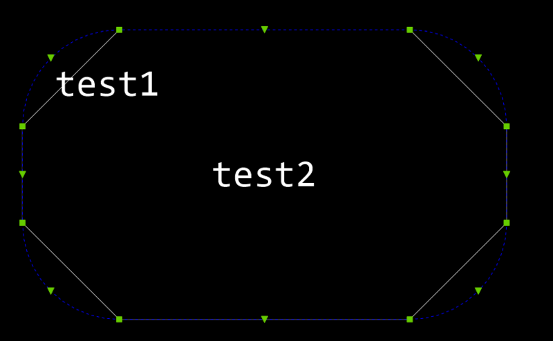

mhupp Posted July 26, 2021 Share Posted July 26, 2021 (edited) @confutatis my 2¢ might want to add a closed poly check when selecting the polylines on the boundary layer. you can still return an area on an open polyline and it might not be the full plot area. (if (not (and (setq ss (ssget '((0 . "LWPOLYLINE")(8 . "BOUNDARY")(70 . 1)))))) Also I didn't know this about 3 months ago but WP works great with polylines unless its has arcs. if you use the polyline vertices with WP selection window it will cut corners when their is an arc. Example it wont pick up "test1" text because its outside the white selection window. granted this probably isn't a problem with plots, but caused quite a bit of finger pointing at my work when one of my commands wasn't picking up everything "inside" the polyline. fix here Edited July 26, 2021 by mhupp 1 Quote Link to comment Share on other sites More sharing options...
confutatis Posted July 26, 2021 Share Posted July 26, 2021 You're right, I hadn't accounted for closed polylines, though it should be the post author's job to verify that. However, the problem is easily solved with a fairly trivial command that I created some time ago and that is the closure of all open polylines selected, even those with the first vertex coincident with the last, but considered open. As for WP selection on curves, I had created a program similar to Lee Mac's, to convert arcs to line segments. I didn't look closely, but it seemed to me that there were no curves on polylines. What is represented on the DWG should be cadastral parcels, usually defined by polylines with no curved lines. Quote Link to comment Share on other sites More sharing options...
