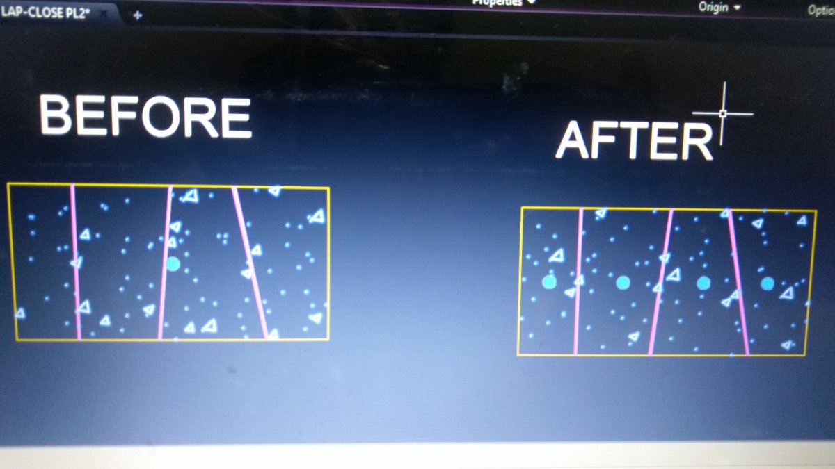

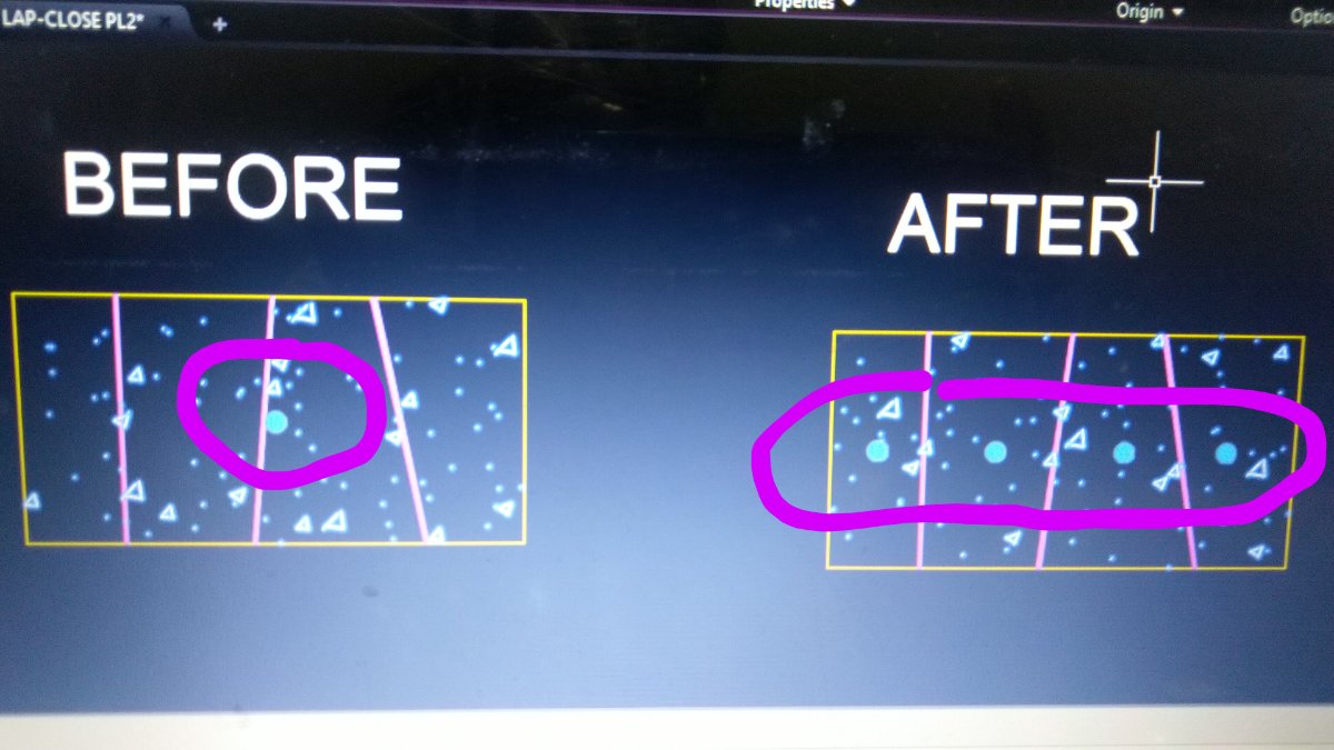

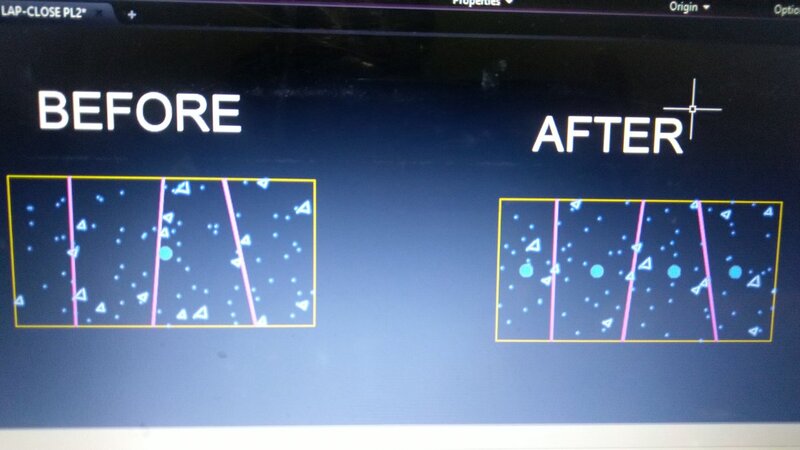

Ish Posted July 21, 2021 Share Posted July 21, 2021 (edited) Dear , Any lisp program for split hatch from main hatch , Automatically split after select line/pline. Each part must have separate hatch. See attach image for more information. Edited July 21, 2021 by Ish Modified Quote Link to comment Share on other sites More sharing options...

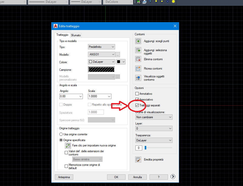

confutatis Posted July 21, 2021 Share Posted July 21, 2021 (edited) I don't use AutoCAD English version, but the sequence is the same. Edited July 21, 2021 by confutatis Quote Link to comment Share on other sites More sharing options...
Ish Posted July 21, 2021 Author Share Posted July 21, 2021 1 hour ago, confutatis said: I don't use AutoCAD English version, but the sequence is the same. I try but can not separate hatching. Enter HATCHEDIT on the command line. Select the hatch. In the Hatch Edit dialog box, click Recreate Boundary. When you see the prompt "Enter type boundary object", enter P for polyline or R for region. When prompted … Quote Link to comment Share on other sites More sharing options...
eldon Posted July 21, 2021 Share Posted July 21, 2021 When the hatches are created, make sure the system variable HPSEPARATE is set to 1. In HATCHEDIT, make sure the option of making separate hatches is checked, before you Recreate Boundary. Quote Link to comment Share on other sites More sharing options...
