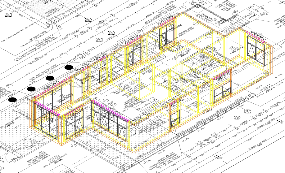

BIGAL Posted July 21, 2021 Posted July 21, 2021 (edited) Not sure what your doing wrong this is what you are talking about, but Autocad or Bricscad. Only way for any one to check would be to post a dwg and a pdf. Edited July 21, 2021 by BIGAL 2 Quote
