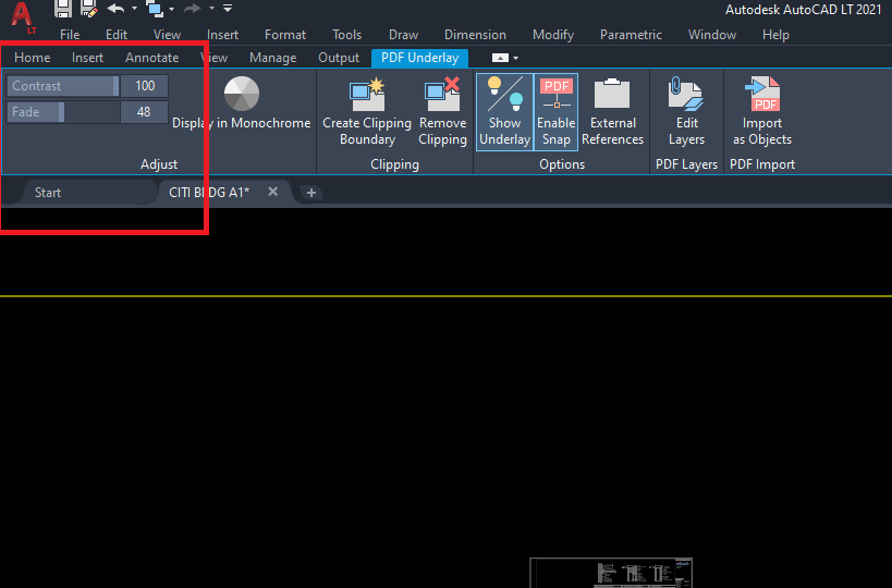

Hi !
having an issue with the transparency of he X-Refs.
the working base seems to show through to the D3 drawing and also print slightly faded but perfectly acceptable.
However the schedule  layer (alone) which is on the D2 drawing is barely visible.
I have checked the transparency setting within the layers menu and it is set at "zero" in both the D2 and D3 drawings.
Anybody have any thoughts or ideas ?
What does the transparency look like on the xref ribbon when you have each separate xref selected?  See image, red box.
This is in addition to the layer or any other transparency property, including any separate object properties that the author of the xrefs made.
