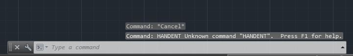

ChristopherM Posted July 7, 2021 Share Posted July 7, 2021 Hi I am trying to figure out how to select an entity by its handle but there is not much info on the topic. What I did find out was that there is a HANDENT command to select the object but it is not working for me. I am on AutoCAD 2018. And I type in HANDENT then press spacebar to type in the ID "45b" but as soon as I press space it tells me unknown command. Is this a LIPS I need to load ? Where to find it though ? Also tried HANDENT"45b" but no luck :D How to find/select an object by its handle ? Quote Link to comment Share on other sites More sharing options...

ChristopherM Posted February 4, 2022 Author Share Posted February 4, 2022 Somewhat super late. Thanks for the explanation on how to use it. But seems to miss the very basic where do I get the HANDENT autolisp. I am assuming I need to download the file and load it in CAD to be able to use it? But don't seem to be able to find it anywhere. Or am I still at a loss on how this works Quote Link to comment Share on other sites More sharing options...

ChristopherM Posted February 5, 2022 Author Share Posted February 5, 2022 22 hours ago, eldon said: Did you follow the link given? All the information is given, but needs to be read. Lol sigh people, smarty pants same goes for my post. As you see on the top. Writing HARDENT like the link says gives me the error unknown command. 1 Quote Link to comment Share on other sites More sharing options...
Warren E. Black Posted February 5, 2022 Share Posted February 5, 2022 Apparently you did not read the above post 1 Quote Link to comment Share on other sites More sharing options...
steven-g Posted February 5, 2022 Share Posted February 5, 2022 36 minutes ago, ChristopherM said: Writing HARDENT like the link says gives me the error unknown command. At some point the lighgtbulb will go on. Lisp has to be contained in parenthesis () there is nothing to download it is built in re-read @tombu's post above and include the (). And it is HANDENT not HARDENT Or is your profile not correct and you are actually using LT and not the full version of Autocad in which case nothing will help as Lisp is not found in LT 1 Quote Link to comment Share on other sites More sharing options...
eldon Posted February 5, 2022 Share Posted February 5, 2022 44 minutes ago, ChristopherM said: .....As you see on the top. Writing HARDENT like the link says gives me the error unknown command. Unfortunately you were not advised to write HARDENT, you were advised to write (HANDENT .... AutoCAD needs to have a way to distinguish between AutoCAD commands and AutoLISP expressions. AutoCAD identifies an AutoLISP expression by its opening parenthesis. Each time AutoCAD detects an opening parenthesis, it passes the entire expression which follows to AutoLISP. AutoLISP evaluates the expression and returns the result to AutoCAD. AutoCAD uses the results and continues. A typical AutoLISP expression has this syntax: (function argument) It is a pity that you did not manage to discover this with your search of information. 1 Quote Link to comment Share on other sites More sharing options...
