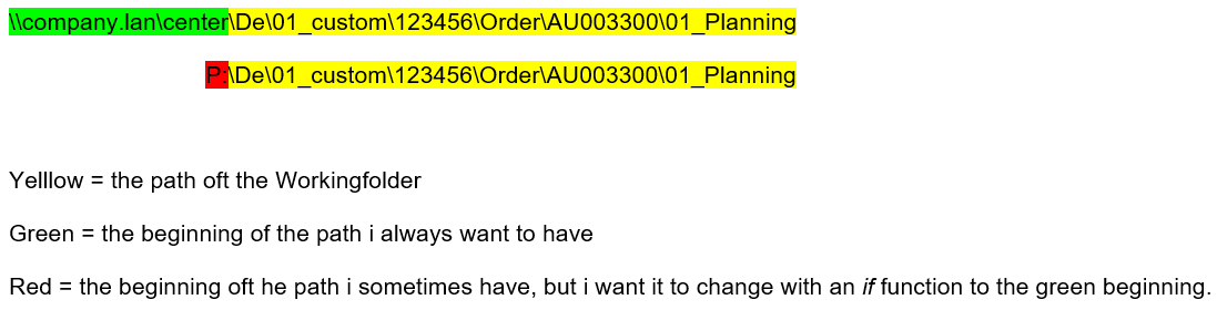

Hi, I want to change the beginning of my path (the workingfolder) if the path starts with "P:\" (marked red) and replace it with the path marked green. (with an if - function).
(The destination location is the same, but the access is through a different network).
Is it possible to change the beginning with an If - function and change the Path this way?

Yes, exactly. Do you know of an If function that will only execute the Stract command if "P:" is at the beginning of the path?
(if (vl-string-search "P:\\" (getvar "DWGPREFIX"))
 (strcat "\\\\company.lan\\center" (substr (getvar "DWGPREFIX") 3 (strlen (getvar "DWGPREFIX"))))

(if (= (substr (getvar 'dwgprefix) 1 2) "P:")
  (strcat "\\company.lan\center" (substr (getvar "DWGPREFIX") 3))

The path would always have something a start re drive ? If not P: then what ?

Sounds like you have people accessing files through UNC ? If so perhaps:
(if (wcmatch (setq dp (getvar "DWGPREFIX")) "P:*")
  (strcat "\\\\company.lan\\center" (substr dp 3))
  dp
*EDIT Changed (substr dp 1 2) to (substr dp 3)

It works, thank you so far.

I had a typo changed above.
