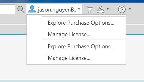

I have users that are running 2018 without issue and the same users also have 2021. Geolocation works fine with 2018 but with 2021 their 360 login name is present but geolocation will not load maps. Opening the same file in 2018 works fine. The other item is when the pull-down is selected next to their sign in name the only two options are: Explore Purchase Options and Manage License. The two options above, Sign Out and Account Details are not displayed. Any help is greatly appreciated.

Thank you for your reply, I still receive the same error, please see attached. If you have any other suggestions please let me know.

I did contact our reseller and they said they don't have a solution but they'll get back to me if Autodesk replies to them. I'm still on them as this is not even close to a resolution. The attached image is what I get in 2021, those two lines will duplicate every time I try to login. I can open the file in 2018 and it's all good but the same file shows no map in 2021. I have logged out, logged back in and credentials will show in 2021 but no maps and no way to log out in 2021. Even made a new account, same result. I've also removed the Web Services folder with  no luck. Any other suggestions are welcome.
