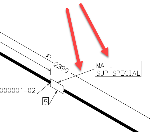

mehrdad Posted June 21, 2021 Share Posted June 21, 2021 Hi, I have lots of AutoCAD drawings and i want to delete the word shows in the attached image along with the side lines. is it possible to do this with a script or lisp? Thank you Quote Link to comment Share on other sites More sharing options...

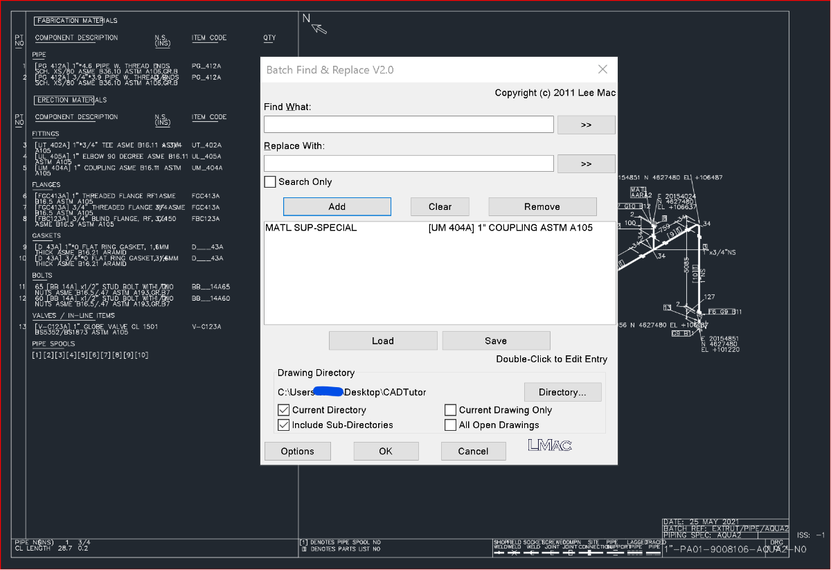

Dadgad Posted June 21, 2021 Share Posted June 21, 2021 What is it that needs changing/ Check out this link to the legendary LeeMac's Batch Find & Replace lisp. You don't even ned to open more than one drawing to use it. Done in a minute or two if it is text? http://www.lee-mac.com/bfind.html Thanks Lee! 1 Quote Link to comment Share on other sites More sharing options...
Dadgad Posted June 21, 2021 Share Posted June 21, 2021 (edited) Are you looking to change the BOM callout for item #5? Lee's lisp would do that, just open one to define your search parameters. Edited June 21, 2021 by Dadgad Better screenshot, more on point Quote Link to comment Share on other sites More sharing options...

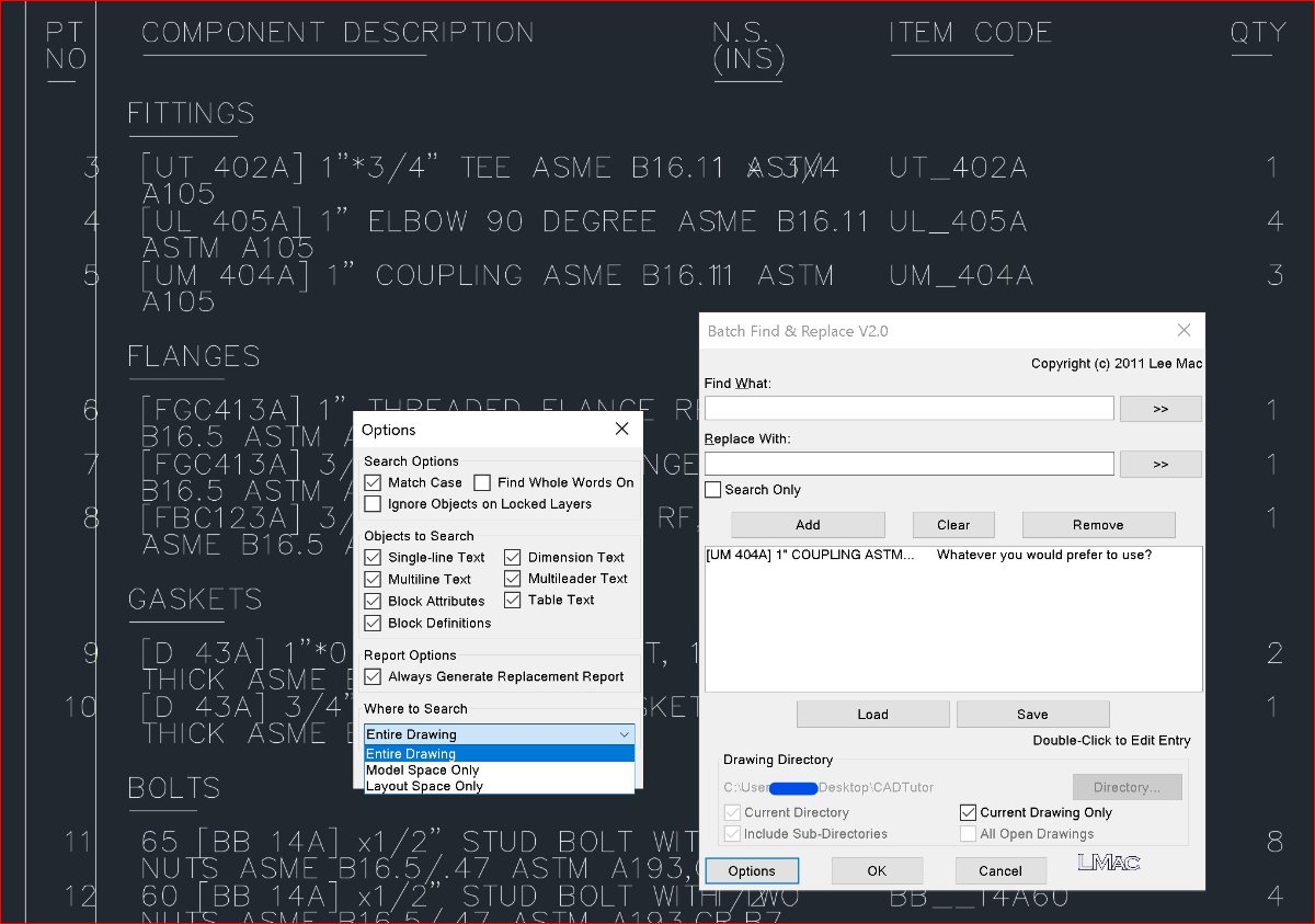

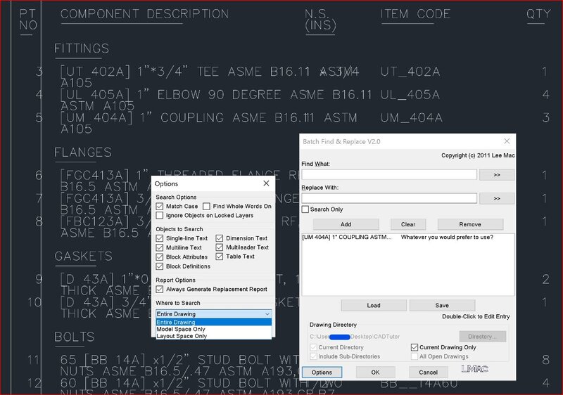

Dadgad Posted June 21, 2021 Share Posted June 21, 2021 If the problem is TEXT, no problem. Hoping BFIND can rescue you. Open a single file from the folder or directory where your files are > Define your desired changes Browse to the directory, if it is not your current Directory Look at Options possibly? Hit OK and it will go through your 4,000 files in a few minutes, no drama. Don't forget to make a modest donation to Lee, if you can, as well as a tip of the hat. If not maybe Tharwat has something on his website. https://apps.autodesk.com/ACAD_E/en/Detail/Index?id=134530920785950835&appLang=en&os=Win32_64 Quote Link to comment Share on other sites More sharing options...

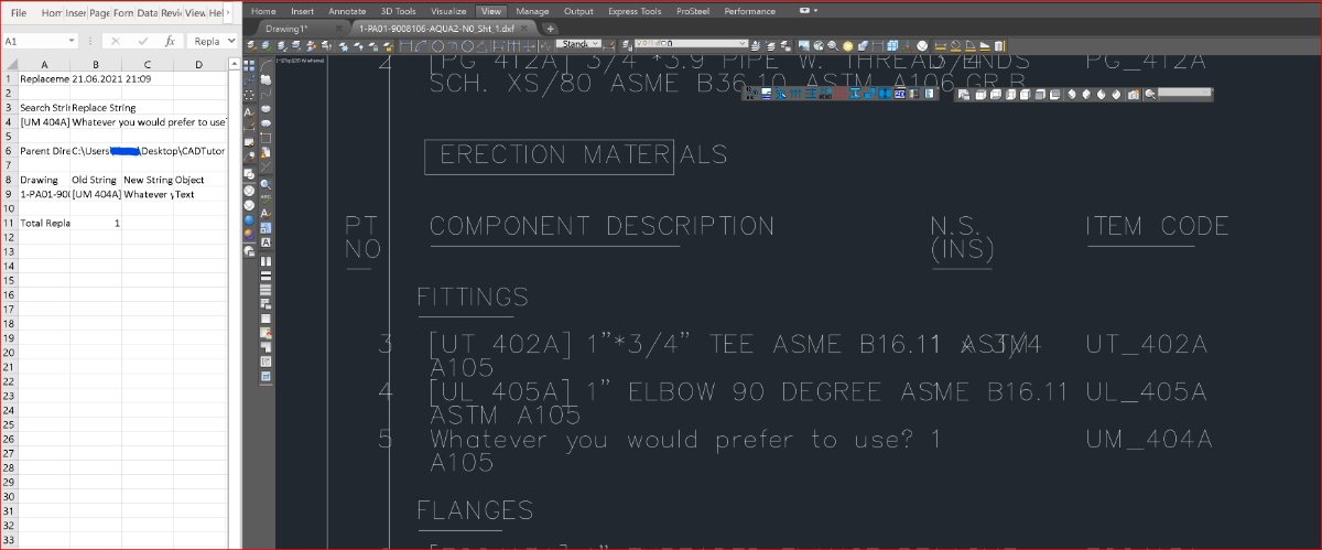

Dadgad Posted June 21, 2021 Share Posted June 21, 2021 You can try to lead a horse to water...It will even print out a report of all of the drawings in which it was founf and changed! LeeMac RULES! Quote Link to comment Share on other sites More sharing options...
mehrdad Posted June 21, 2021 Author Share Posted June 21, 2021 Thank you very much for your guidance, But how do we eliminate the sidelines? Quote Link to comment Share on other sites More sharing options...
Dadgad Posted June 21, 2021 Share Posted June 21, 2021 You are welcome. It is 9:30 p.m. and after my workout I didn't go down for dinner because I hoped that I might be able to help you. Sorry I don't know any magical way to eliminate them. I am afraid you will be opening those 4,000 drawings after all, and I am going to step away from the magic box now and enjoy some dinner. Good luck with them, maybe another forum member will know a clever way. Quote Link to comment Share on other sites More sharing options...
BIGAL Posted June 21, 2021 Share Posted June 21, 2021 In the sample dwg everything is on 1 layer making life very hard, does the dwg exist with different layers ? The only way I see is Find plines Also look for a line touching, If line exists get the other 2 lines get text inside. Erase all the objects You have some small pline boxes with say a single number but no line attached so take it for granted that is to remain. Using Aeccorconsole would be the way to go with a lisp. Quote Link to comment Share on other sites More sharing options...
