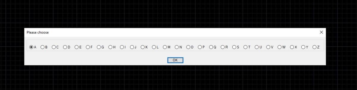

 for 2 I had a go using Multi radio buttons there is a option for A-Z its in the code examples at start of code, uses a defun to make the A-Z list its pushing the limits, use "H" horizontal option, when ran a variable BUT is set this is last item picked so default button will change to match last picked.
(if (not AH:Butts)(load "Multi Radio buttons.lsp"))
(if (not but)(setq but 16))
(setq ans2 (ah:butts but "h"  (make_letters "Please choose" 65 26)))
image.thumb.png.fd410049135041b8234d74588c91e220.pngMulti radio buttons.lsp

2 hours ago, BIGAL said:
For 1
(vlax-for block (vla-get-blocks (vla-get-activedocument (vlax-get-acad-object)))
maybe do wcmatch i ie blk1002 ie found a block with 1002 in name
image.thumb.png.fd410049135041b8234d74588c91e220.png Multi radio buttons.lsp 3.38 kB · 1 download
