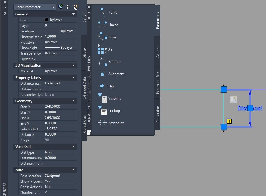

rcb007 Posted June 17, 2021 Author Posted June 17, 2021 Interesting, I was trying to use the one parameter to move / slide it up and or down, but it only goes from the starting up and not past the starting point. Quote

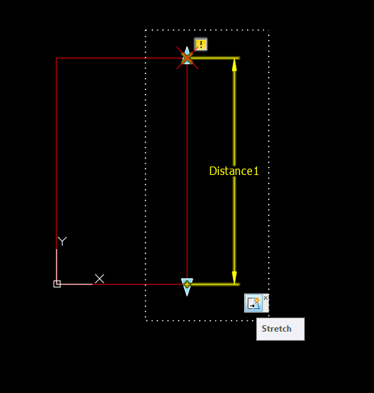

Dana W Posted June 18, 2021 Posted June 18, 2021 (edited) You only need a rectangle, one linear parameter and one stretch action. I say rectangle instead of lines because the corners are solid 90 deg. and already joined. it's just faster than mucking around with lines. The trick is including one side and both adjacent corners in the stretch frame. An image of the block editor and a dwg file of the block are attached. This lets the right side slide up and down while dragging the corners with it. Is that what you want to do? If this block's layer gets into a drawing, you will need to go into the block editor and move all the red lines to the layer 0 (zero). I created it on my layer named NO PLOT, which is exactly what it does. It does not plot. RECT.dwgFetching info... Edited June 18, 2021 by Dana W Quote
rcb007 Posted June 22, 2021 Author Posted June 22, 2021 Thank you for your help! I do have a question of why does the arrow not go past the 0,0 horizontal line. It will not let me drag it any further? Quote

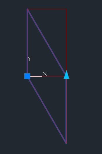

Dana W Posted July 16, 2021 Posted July 16, 2021 How about this. All I could come up with was adding a flip action so you can pull it the other way when you need to. I know it's another click but ... >shrug< Simply mirroring the whole block doesn't work either. Apparently, one cannot stretch a distance parameter past its own zero length. I'm not thinking far enough outside the box. RECT.dwgFetching info... Quote

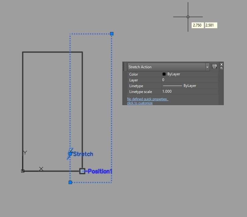

danellis Posted July 16, 2021 Posted July 16, 2021 Don't stretch a distance, stretch a point dJE stretch.dwgFetching info... Quote
Dana W Posted July 18, 2021 Posted July 18, 2021 Wow, that easy? Where's the facepalm Imogi when you need him? Could add constraints to hold the width, I guess. Quote
