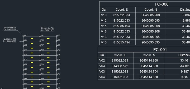

Hi Guys
I come to ask for an adaptation in a table, I will post the images and attachment to better understand,
I'm grateful for some help.
As this is important to me, I will make a donation of 20 U$ for those who can, as thanks for the help.
Seeyha

Here you are...
I tested it only on AREA polylines and it worked...

However, if I was to be asked how should table look like, I'd suggest something like this (double vertices in table represent segments of polyline)... BTW. It works and for S areas...

marko_ribar
thanks for the help, It was fast thanks a lot.
just send the link for me do it.
One review,
check this dwg i dodnt know why brake it.  if not find a side can return a null (or any word).
model test2.dwg
@leo321
You must modify position of TEXT entities prior running "atratbl.lsp" to be at exact position of polygons centroids... Some errors arise due to placement of CAD entities far from origin point 0,0,0... I had to revise my code and I am posting new one which you must run before main routine...
It should be working as desired after applying fix...
MAIN ROUTINE : areatbl.lsp

Right! I will gladly send your lunch(kkkk)
of course it's symbolic, because I value this talent a lot.
thanks a lot
Sorry to bother, when you have time
I did some test, the table returned a bit messy.
I don't know if it happened to you
Drawing TEST3.dwg
