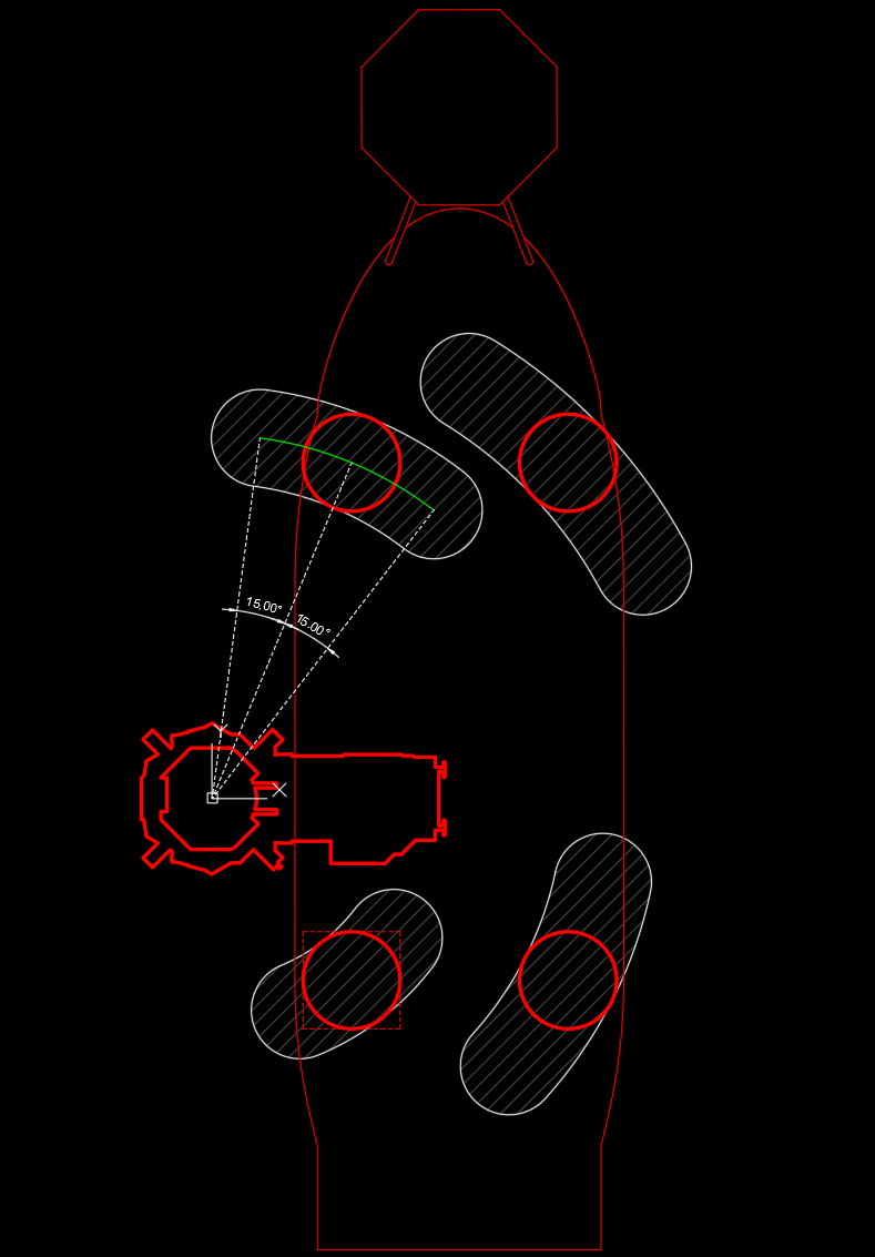

Hi,
I was wondering if it is possible to create a closed polyline which exists of 2 offsettet Arcs and closed endcaps with circles
The shape looks like a saucage (I have attached a picture).
The input would be:
1. Select base point (which is always 0,0)
2. Select the 4 red Circles
3. Enter the Angle (e.g. 15 degrees)
Note: the Location of the 4 red circles may be shifted in Y-direction, but the base point stays 0,0
YES !  Have a go its the best way to learn. This is a good exercise example fairly straight forward.
Write down the steps then convert to lisp.
enter angle
Pick centre pt
while
pick circle get centre and radius
do some point calcs for start end of arc.
arc start end 1/2 rad
fillet rad 0 startptarc1 startpt2 1/2rad
offset rad
endwhile
Hints
for circle (entget (car (entsel "\npick circle .....)  look at (cdr (assoc 10 & (cdr (assoc 40
For start end points need to use (polar cen ang dist)    +- 1/2angle of the angle from centre point to center of circle
Edited by BIGAL
Thanx for the hints, I'll try
Just want to say that this is not so easy task...
(defun c:MontyPytonsFlyingSausages
  ;;; variable declarations
  ( / ss angle-degrees point-zero angle-radians circ-ent circ-el circ-cen circ-rad circ-dist
      circ-ang inside-arc-dist outside-arc-dist inside-arc-LR outside-arc-UL ss->el)
  (defun ss->el (ss / i l)(setq i 0)(repeat (sslength ss)(setq l (cons (ssname ss i) l) i (1+ i))) l)
  ;;; main routine
  (if (and (setq ss (ssget '((0 . "CIRCLE")))) (setq angle-degrees (getreal "\nEnter angle offset : "))
           (setq point-zero '(0.0 0.0 0.0)) (setq angle-radians (* pi (/ angle-degrees 180.0))))
    (foreach circ-ent (ss->el ss)
      ;;; get circle elist
      (setq circ-el (entget circ-ent))
      ;;; get circle center point
      (setq circ-cen (cdr (assoc 10 circ-el)))
      ;;; get circle radius
      (setq circ-rad (cdr (assoc 40 circ-el)))
      ;;; get angle & distance from 0,0 to circle center
      (setq circ-dist (distance point-zero circ-cen))
      ;;; get angle between point-zero and circle (radians)
      (setq circ-ang (angle point-zero circ-cen))
      ;;; compute distances for inside & outside arc
      (setq inside-arc-dist (- circ-dist circ-rad) outside-arc-dist (+ circ-dist circ-rad))
      ;;; compute all arc-points (clockwise)
      (setq inside-arc-LR (polar point-zero (- circ-ang angle-radians) inside-arc-dist))
      (setq outside-arc-UL (polar point-zero (+ circ-ang angle-radians) outside-arc-dist))
      ;;; draw pline
      (command ".pline" outside-arc-UL "arc" "CE" point-zero "ang" (- 0 (* angle-degrees 2.0))
               inside-arc-LR "CE" point-zero "ang" (* angle-degrees 2.0) "close" )
;;; shortcut
(defun c:t1 ()(c:MontyPytonsFlyingSausages))

Nice one rlx!
I like how you use the pline center and ang functions so you don't have to calculate all the points.
When I was trying the code I did have some problems with snap.
So for gsc: if you replace the last line with this, you wont have those problems.
(command ".pline" "_none" outside-arc-UL "arc" "CE" "_none" point-zero "ang" (- 0 (* angle-degrees 2.0))
         "_none" inside-arc-LR "CE" "_none" point-zero "ang" (* angle-degrees 2.0) "close" )
This one is a bit long winded but works as well - this follows how I would make the sausages up manually.
I am putting this here because I added a check that the angle isn't greater than 360 degrees (probably should be less than that) and added a line if needed to select the centre point.
I did most of this yesterday before rlx posted his solution - otherwise I would use his, his looks nicer.

make-sausages.lsp 10 sausages.dwg
  ;;; main routine
      ;;; draw pline
;;; shortcut
J4F (just for fun)
Hahahaha...You're working at the ministry of funny lisps, I guess?
Working great though...Thanx!
Well , actually I work at Miss , the Ministry of Silly Sausages 😜
