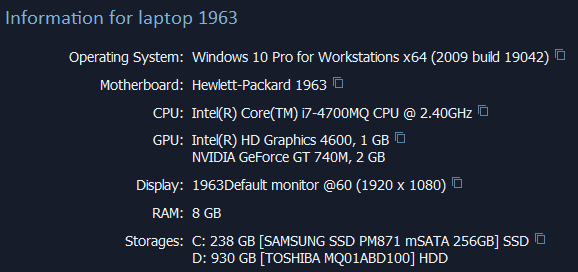

Saqib_theleo Posted June 11, 2021 Share Posted June 11, 2021 Hello all, I have a little problem. I don't know if it is only happening to me, when I change my Workspace to any other workspace AutoCad hangs or freezes for few seconds (8 to 12seconds) after this it works well and smoothly. I tried Autocad 2018, 2020, 2022 same happens to all. Anyone know how to fix this problem. Please try to change your workspace to other workspace and share your result if it happens to you too or not. Thank you. Quote Link to comment Share on other sites More sharing options...
SLW210 Posted June 11, 2021 Share Posted June 11, 2021 No problems here. Maybe graphics card and/or driver. What OS, Computer Specifications, Graphics Card, Driver, etc.? Quote Link to comment Share on other sites More sharing options...
Saqib_theleo Posted June 11, 2021 Author Share Posted June 11, 2021 5 minutes ago, SLW210 said: No problems here. Maybe graphics card and/or driver. What OS, Computer Specifications, Graphics Card, Driver, etc.? these are general specs.. Quote Link to comment Share on other sites More sharing options...
SLW210 Posted June 11, 2021 Share Posted June 11, 2021 Are you sure you are using the Nvidia and not the Intel Graphics? Quote Link to comment Share on other sites More sharing options...

SLW210 Posted June 14, 2021 Share Posted June 14, 2021 2.5–2.9 GHz processor recommended minimum and you're on a laptop with 2.4 GHz. I had weird glitches when I first used AutoCAD 2018, an older driver fixed the issues for the most part until later on I installed a new certified Autodesk driver and it worked pretty good. You might try some different drivers. Quote Link to comment Share on other sites More sharing options...

Saqib_theleo Posted June 15, 2021 Author Share Posted June 15, 2021 (edited) On 6/14/2021 at 3:32 PM, SLW210 said: 2.5–2.9 GHz processor recommended minimum and you're on a laptop with 2.4 GHz. I had weird glitches when I first used AutoCAD 2018, an older driver fixed the issues for the most part until later on I installed a new certified Autodesk driver and it worked pretty good. You might try some different drivers. but it can go up to 3.4ghz....if processor was issue then during work and 3d views should be a problem too..I'll try to some other driver and see..Thank you.. Edited June 15, 2021 by Saqib_theleo Quote Link to comment Share on other sites More sharing options...
