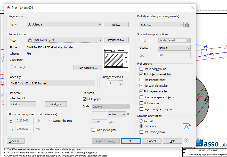

I've checked online a few porcedures which i linked below, but still I don't succeed to batch plot / publish multiple DWGs because the page setup doesn't want to load, so I am unable to print anything because  batch plot doesn't let me see the page setup...
455594786_Screenshot-6_8_20211_58_14PM.thumb.png.ff46319c3c637de7968ce4e2c7850411.png
i tried to create several page setups... but they are never available in the  batch plot page... i only see default none and import, and import doesn't work
i applied what i learned from here below, and i tried a few times, but it doesn't work for me...
please help, thank you!! :)

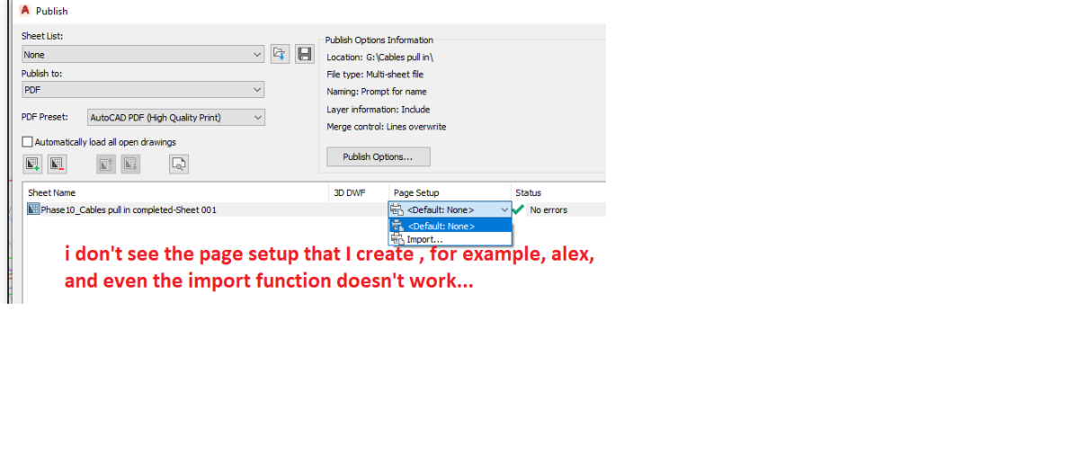

Do you have multiple page setups for each layout?  If not, then it feels like you are making this too complex.
Just set the page setup that you want to use for each layout current (it doesn't even have to be a named page setup).
Then when you print or publish, AutoCAD will use the current settings (which could be a named page setup) for printing.
IOW, there is no action needed to "choose" a page setup or any other settings, AutoCAD uses what is current for printing or publishing.
Publishing from Sheet Set Manager is even easier, since it's just a couple of clicks.
Last tip: Make SURE that background printing and publishing is NOT enabled.

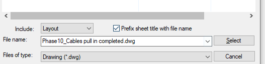

thanks rkmcswain,  i don't have multiple page setups for each layout... actually i am not even able to save a layout, cause when I try, and i give it a name, then next time i open CAD, it is gone , but ok, that's not an issue because I set, plot previous and it works, for a single plot.
Batch plot doesn't work.   this is what I get when I try: I don't get any choice of page setup, in the batch plot... only Default and Import.....
no , it is not enabled..

A couple things.
When you create a new page setup you have to save the drawing afterwards or it won't remember you created it.  That might be why you are seeing the page setups disappearing after you create them.
When you use the publish option, <Default: None> means the publisher is going to use whatever page setup has already been set up for a specific layout/sheet before you ran the publish command (whatever is "current").
I use a slightly different method for selecting page setups just because mine are already set up in the template files for my title blocks.
But if you needed to change the page setup I would do that before publishing so you know they are configured properly.
So if you had like 4 sheets/tabs, You can create one page setup for one of those sheets, then you can apply that page setup to the other tabs by selecting it from the list.
Another trick is to specify a page setup to the model space tab and then Autocad will ask if you want to apply it to all sheets in the set.
Then save, then publish.  And the publisher already knows what page setup you want to use (the "current" page setups are already correct).
And that way you don't have to specify a (potentially) completely different page setup and sheet size that could give you an undesirable result.
For the purposes of all my company's title blocks I always specify DWG to PDF at the standard size, apply my CTB file, etc...
I do that specifically so that I can publish the entire set much easier and I don't have to click a completely different page setup in the publish dialog drop down menu.  Because the "current" page setups are correct.
If you need to print directly from autocad to a plotter or other network printer, you can either set up a second page setup for that and select it from the drop down menu in the publish dialog box or you can simply print the PDF you already published.
For ease of use, sheet set manager is definitely a great option.
Printing is super easy and is the fastest method in Autocad to print multiple sheets in the set.  There are also LISP routines that can batch plot all open drawings with one click (to the "current" page setup config) similar to how SSM works.  The previous design firm I worked at used a LISP to do that because they didn't like SSM.
