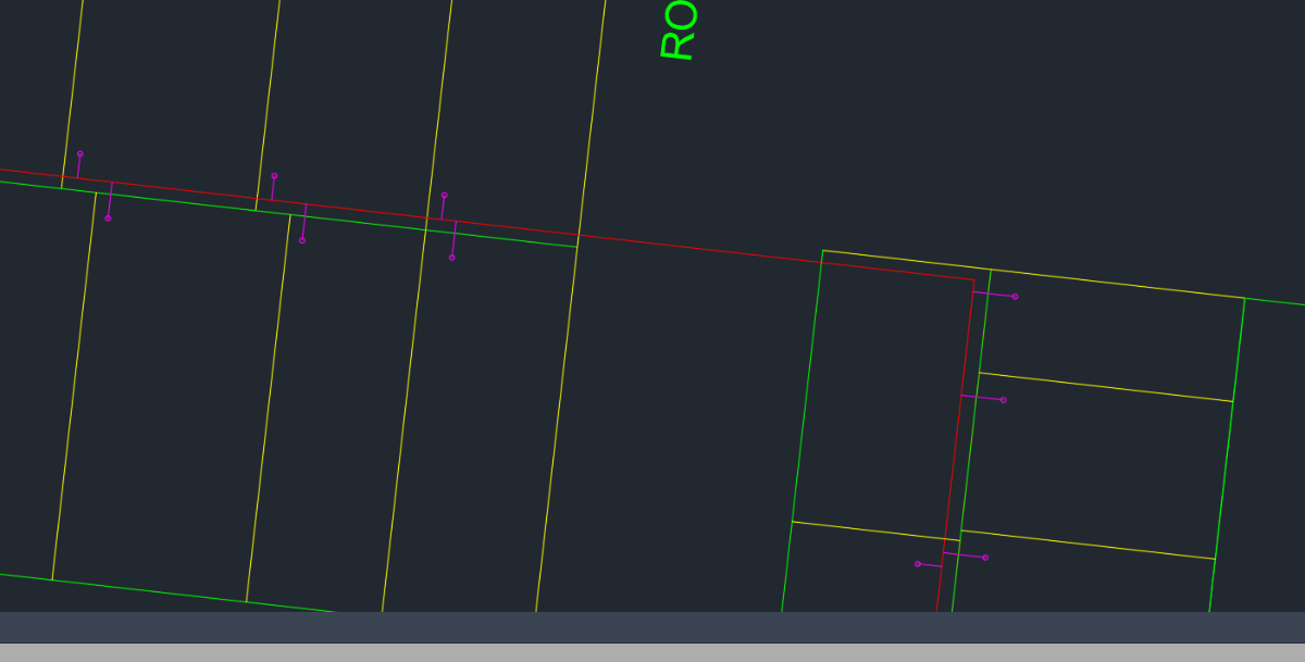

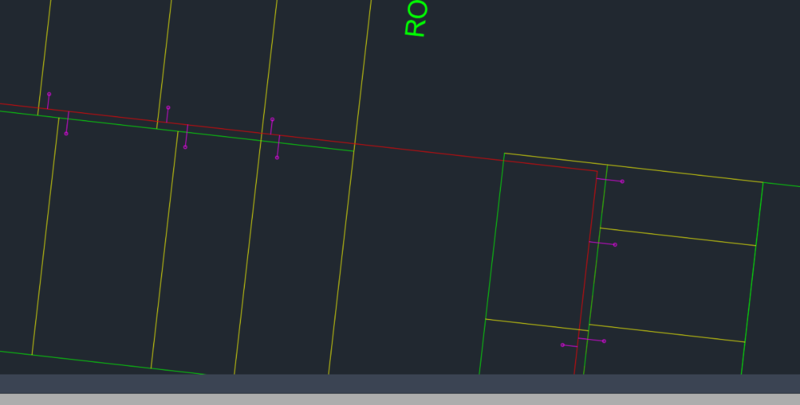

laijumalias Posted June 5, 2021 Share Posted June 5, 2021 Hi All, First of all thanks for LeeMac for the free code which I tried to modify to suit I am a beginner in LISP. The situation is to place a property connection block for each property boundary in perpendicular to the service line at a specific distance from intersecting point, The yellow line in the image is prop boundary and red continues is the service main line and magenta lines are the property connections, what I am trying to do is automate the placement of the magenta blocks one for left and the other for right (i.e. if the property line directly intersect the service line "Left" block will inset and when the property line extension intersect the service line "Right" block to insert. The insertion point is 1.2m away from the intersection and there should be at least 0.5m gap between left and right property connections. I was Trying to use the code by LeeMac by modifying it to insert a block in all the intersection of a line crossing with another as follows. But it always places the block in co-ordinates as per WCS. In all the portions added by me I have inserted a comment what I am expecting the code to do. When ever I run the following code the blocks are placed some where in space, if the UCS is not WCS. It would be good if it can run along the Service polyline changing the UCS direction in one click rather tan selecting each segment one by one for block placement. Thank you all in advance. ;; Intersections Between Sets - Lee Mac ;; Returns a list of all points of intersection between objects in two selection sets. ;; ss1,ss2 - [sel] Selection sets (defun LM:intersectionsbetweensets ( ss1 ss2 / id1 id2 ob1 ob2 rtn ) (repeat (setq id1 (sslength ss1)) (setq ob1 (vlax-ename->vla-object (ssname ss1 (setq id1 (1- id1))))) (repeat (setq id2 (sslength ss2)) (setq ob2 (vlax-ename->vla-object (ssname ss2 (setq id2 (1- id2)))) rtn (cons (LM:intersections ob1 ob2 acextendnone) rtn) ) ) ) (apply 'append (reverse rtn)) ) (defun c:xs ( / ss1 ss2 ) (setq uob (entsel "\n Select object for ucs :")) ; request for Object selection to set UCS (command "ucs" "ob" uob) ; Set the UCS to the Object in the previos selection (if (and (setq ss1 (ssget)) (setq ss2 (ssget)) ) (foreach pnt (LM:intersectionsbetweensets ss1 ss2) (entmake (list '(0 . "POINT") (cons 10 pnt))) (trans pnt 0 1 0) ; Convert point from WCS to UCS (command "-insert" "SL" pnt "" "" "") ; Insert block named "SL" at each intersection point ) ) (command "ucs" "p") ; Reset the UCS to previous state (princ) ) (vl-load-com) (princ) Quote Link to comment Share on other sites More sharing options...

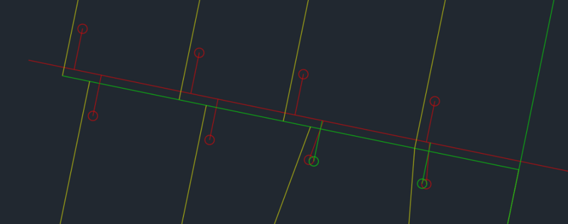

laijumalias Posted June 9, 2021 Author Share Posted June 9, 2021 Thanks BIGAL, Sorry for the delay in getting back to you. This code works wonders, but I have some suggestions if you have time and possible, I have tested the code without the multi radio button and found out that by changing the Pline direction we can achieve the expected result if the insertion point is upstream or down stream. See the attached result the property connection should be always perpendicular to the Main line regardless of the property boundary some times the property boundary is slanting to the sewer line(see the Green block prop connection is the expected one against the red which is done by LISP), also if we can select the block instead of having the block name in the code, so we can use this same code for sewer as well as water connections, finally instead of selecting the property boundary one by one if we can select all of the at time with fence/window/Crossing window it will be amazing. sewer PB.dwg Quote Link to comment Share on other sites More sharing options...
BIGAL Posted June 10, 2021 Share Posted June 10, 2021 Will see if can find time, you are right about pline direction easy fix. Say reverse 1st connection then reverse pline so rest are correct. For block name (setq bname (cdr (assoc 2 (entget (car (entsel "\nPick a block")))))) put in code say pick block, pick sewer. and (command bname pt2 1 1 (- ang (/ pi 2) )) Yes can do a fence option, why not have a go ! Will help when you get stuck. Quote Link to comment Share on other sites More sharing options...
