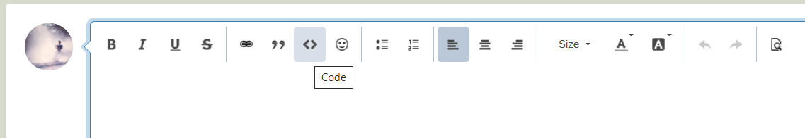

Just a suggestion when posting code use the Code icon it will put it in a box for you, welcome aboard.
