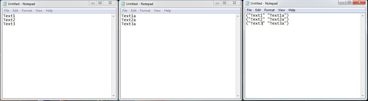

& I need little more from silva as below Image.
Merge 2 notepads & create new
Edited by Gentile Romano

You're welcome, @Gentile Romano
A quick one, minimally tested...
(defun c:demo (/ file file1 file_n fname fname1 fname_n i l lst lst1 n)
  (if (and (setq fname (getfiled "Select the first Text file" (getvar 'dwgprefix) "txt" 0))
	   (setq file (open fname "r"))
	   (setq fname1 (getfiled "Select the second Text file" (getvar 'dwgprefix) "txt" 0))
	   (setq file1 (open fname1 "r"))
	   (setq fname_n (getfiled "New Text File" (strcat (substr fname 1 (- (strlen fname) 4)) "-NEW") "txt" 1))
	   (setq file_n (open fname_n "w"))
      (while (setq l (read-line file))
	(setq lst (cons (strcat "(\"" l "\" ") lst))
      (close file)
      (setq lst (reverse lst))
      (while (setq l (read-line file1))
	(setq lst1 (cons (strcat "\"" l "\")") lst1))
      (close file1)
      (setq lst1 (reverse lst1))
      (setq n 0)
      (if (= (setq i (length lst)) (length lst1))
	  (while (< n i)
	    (write-line (strcat (nth n lst) (nth n lst1)) file_n)
	    (setq n (1+ n))
	  (close file_n)
	(prompt "\nFiles do not have the same number of lines... ")
Hope this helps,
Henrique
