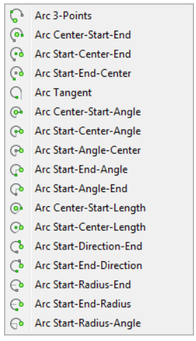

How do I draw and arc length of 24 at a radious of 32.87?

Just look at Help this is from Bricscad the option you want is there.

For me it would be quicker to draw the circle with radius 32.87, break the circle and then use Lengthen to get to the arc length of 24.
One could draw an arc with End and Radius options. Like so:
Command: a ARC
Arc creation direction: Counter-clockwise (hold Ctrl to switch direction).
Specify start point of arc or [Center]:
Specify second point of arc or [Center/End]: e
Specify end point of arc:
Specify center point of arc or [Angle/Direction/Radius]: r Specify radius of arc: 32.87
Then use LENGTHEN command as noted above. Like so:
Command: leg
LENGTHEN
Select an object or [DElta/Percent/Total/DYnamic]: t
Specify total length or [Angle] <1.000)>: 24
Select an object to change or [Undo]:
