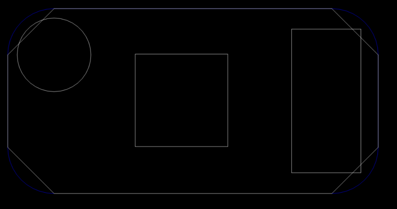

Just and quick FYI because this recently happened to me.
If you are Feeding that point list into (ssget "WP" the corners are cut off at any curve.
The circle and rectangle wouldn't be selected because they are outside the white (ssget "WP" point list of the blue polyline.
To get a more accurate point list use this Entity to Point List
https://www.cadtutor.net/forum/topic/42900-select-within-a-polyline-containing-arcs-and-splines/?do=findComment&comment=350171
