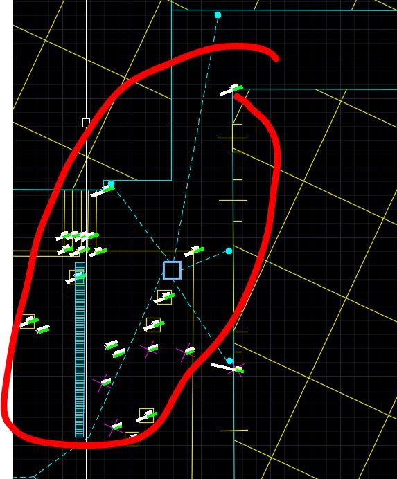

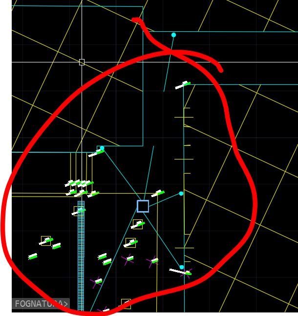

Because in the model space I created lines with a hatch and instead in the layout I see a different hatch, what should I do?
Giovannino60
Because in the model space I created lines with a hatch and instead in the layout I see a different hatch, what should I do? Thank you
I believe you have two different linetype scales. That's not really a hatch, although it is a pattern.
Check your system variables PSLTSCALE and MSLTSCALE. Compare the current annotation scale of your model space to the scale of the viewport. Do some research on linetype scales. This is one of the most tricky topics in AutoCAD.
