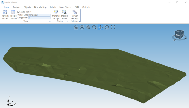

BIGAL Posted May 26, 2021 Posted May 26, 2021 Post a sample xyz file Ronjonp has posted the block. This an example code and has not been tested, it uses Ronjonp's "Foo" block. It will give you an idea of how much simpler it could be. I butchered code so needs cleaning up. ;;;;;;;;;;;; Program that import points. ;;;;;;;;;;;; ;;;;;;;;;;;; ;;;;;;;;;;;; 20201104 V1.1 It's created ;;;;;;;;;;;; (vl-load-com) (defun c:import3 (/ arch descrip thenumber thedescription theelevation linea loc newlist num oldlist posdes poselev posnum x y z z1) (setvar "cmdecho" 0) (vl-cmdf "_.undo" "_begin") ;;; (oldvars) ;;; To store the current variables ;;; (newvars) ; thanks to Lee-mac for this defun ; www.lee-mac.com ; 44 is comma (defun _csv->lst ( str / pos ) (if (setq pos (vl-string-position 44 str)) (cons (substr str 1 pos) (_csv->lst (substr str (+ pos 2)))) (list str) ) ) (setq arch (getfiled "Selec the file with the points ( Pt,Y,X,Z,Description )" "" "*;*" 4)) (setq arch (open arch "r")) (if (/= arch nil) (progn (vl-cmdf "_.layer" "_m" "urb_pt" "_c" "1" "" "" "_.layer" "_m" "urb_pt_num" "_c" "5" "" "" "_.layer" "_m" "urb_pt_elev" "_c" "5" "" "" "_.layer" "_m" "urb_pt_desc" "_c" "5" "" "" "_.style" "romans" "romans" "0" "1" "" "" "" "" ) (setvar "pdmode" 35) (setvar "pdsize" 0.3) ) ) (while (setq linea (read-line arch)) (setq vars (_csv->lst linea)) (setq num (atoi (nth 0 vars)) y (atof (nth 1 vars)) x (atof (nth 2 vars)) z (atof (nth 3 vars)) descrip (nth 4 vars) ) (command "-insert" "foo" (list x y z) 1 1 0 (rtos num 2 0) (rtos z 2 3) descrip) ) ;;; End while (close arch) (vl-cmdf "._zoom" "E") (vl-cmdf "_.undo" "_end") (princ "\n") (princ) ) ;;; End Importa (princ) ) ;;; End Createpoint Quote

BIGAL Posted May 26, 2021 Posted May 26, 2021 (edited) I updated the code above a bit and tested using Ronjonp foo block just copy it out of his sample dwg into a new dwg, copy, paste anywhere, erase, the definition for the block now exists in the new dwg. Lee's solution is much more powerful. Found a couple of minutes so contoured the points. Edited May 26, 2021 by BIGAL Quote
