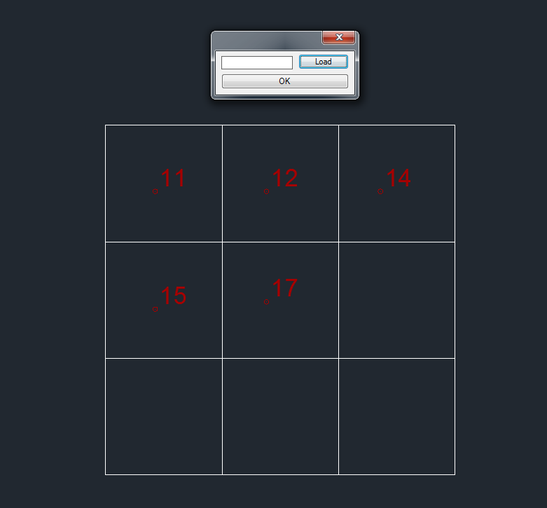

lastknownuser Posted May 19, 2021 Share Posted May 19, 2021 Recently I started learning DCL dialogs and so far I figured out everything I needed but this one I can't, so maybe someone here can help me. Its a simplified example of a much longer code, so I'll just post this part that is bothering me. I have a lot of blocks that have numeric label attribute values, hundreds of them but not all numbers are used (example of labels: 10, 11, 12, 14, 15, 17). I would want a lisp that is asking me to either put a number by keyboard or I could press LOAD button and it would put the next available number in text box (from previous example, by pressing LOAD it would write number 18 and by OK it would start inserting blocks with number 18). So what would be the best solutions to this problem? Here is what I have so far Lisp part: (defun c:test6 () (setq dcl (load_dialog "test6.dcl")) (new_dialog "test6" dcl) (set_tile "number" "") (action_tile "number" "(setq maxnmbr $value)") (start_dialog) (unload_dialog dcl) (setq count (atoi maxnmbr)) (while (setq pt (getpoint)) (command "-insert" "label" pt 1 1 0 count) (setq count (1+ count))) );defun DCL part: test6 : dialog { : column { : row { : edit_box { key = "number" ; edit_width = 15; fixed_width = true;} : button {label = "Load"; key = "load"; width = 12;}} : row { : button {label = "OK"; key = "accept"; alignment = left; width = 12; is_default = true;}}}} Quote Link to comment Share on other sites More sharing options...

lastknownuser Posted May 20, 2021 Author Share Posted May 20, 2021 @BIGAL thank you for reply, I will look into the lisp you mentioned. I probably should have said I'm not an expert in lisp, and even less in dcl. I strarted with it recently to make my job easier and now trying to learn new things and figure out how to implement them in lisp. I put (set_tile "number" "") because I want it to be empty field to enter a number. Sometimes I dont need next available 10 or so numbers so I just write what I need. That part is working but I'd like when I would press "Load" button, it would write next available number in the box so I can see what the next available is, and if its okay I would press ok and accept it. If not, I would edit it in the box by hand. So basically I could either write a new number for label, or by Load it would show me next available and write in the the box, and I could still change it if needed. I attached a photo where you can see it more clearly. Quote Link to comment Share on other sites More sharing options...

BIGAL Posted May 29, 2021 Share Posted May 29, 2021 Try this not sure what your tagname is for Label block, change code. ; https://www.cadtutor.net/forum/topic/73046-dcl-load-next-number-value-into-box/ ; version by AlanH May 2021 (defun writedcl ( / fo) (if (= cnt nil)(setq cnt 1)) (setq fo (open (setq fname (vl-filename-mktemp "" "" ".dcl")) "w")) (write-line "test6 : dialog {" fo) (write-line ": column { " fo) (write-line ": row { " fo) (write-line ": edit_box { " fo) (write-line "key = \"number\" ; " fo) (write-line "edit_width = 15 ; " fo) (write-line "fixed_width = true ; } " fo) (write-line ": button { label = \"Load\" ; " fo) (write-line "key = \"load\" ; " fo) (write-line "width = 12 ; }} " fo) (write-line ": row { " fo) (write-line ": button {label = \"OK\" ; " fo) (write-line "key = \"accept\" ; " fo) (write-line "alignment = left ; width = 12 ; " fo) (write-line "is_default = true ; }}}} " fo) (close fo) (princ) ) (defun resetnum ( / numl ss) (setq numl 0) (setq ss (ssget "X" (list (cons 0 "INSERT")(cons 2 "Label")))) (repeat (setq x (sslength ss)) (foreach att (vlax-invoke (vlax-ename->vla-object (ssname SS (setq x (- x 1))) ) 'getattributes) (if (= tagname (vla-get-tagstring att)) (princ (setq num (atoi (vla-get-textstring att)))) ) ) (if (< maxnbr num)(setq maxnbr num)) ) (set_tile "number" (rtos maxnbr 2 0)) (princ) ) (defun pickpt ( / pt ) (while (setq pt (getpoint "\nPick insertion point ")) (command "-insert" "label" pt 1 1 0 (rtos maxnbr 2 0)) (setq maxnbr (1+ maxnbr)) ) (princ) ) (setq tagname "TAG1") ; for testing (defun c:test6 ( / pt) (if (= maxnbr nil)(setq maxnbr 1)) (writedcl) (setq dcl_id (load_dialog fname)) (if (not (new_dialog "test6" dcl_id)) (exit) ) (set_tile "number" (rtos maxnbr 2 0)) (mode_tile "number" 3) (action_tile "number" "(setq maxnbr (atoi $value))") (action_tile "load" "(resetnum)") (action_tile "accept" "(unload_dialog dcl_id)") (start_dialog) (vl-file-delete fname) (pickpt) (princ) ) (c:test6) 1 Quote Link to comment Share on other sites More sharing options...
lastknownuser Posted May 31, 2021 Author Share Posted May 31, 2021 @BIGAL Thanks a lot, it works! I actually only needed information about writing separate defun for next maximum number and that it is loaded with (action_tile "load" "(resetnum)"), but I will study your code to maybe improve mine. Now I only have a little problem, because it loads the number into box but it doesnt select it unless I click inside the box, if you understand what I mean. So its an extra mouse click but sometimes you can forget, so I'd like for it to select whatever number is just loaded, shown inside the box, any way to achieve that? Quote Link to comment Share on other sites More sharing options...
