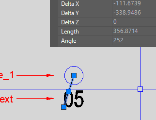

I have attached two drawings. The first  how the current situation is (Drawing1.dwg) and how it should be (Drawing2.dwg).
The distances and offsets are real (for the proximity parameter). My drawings are designed in millimetres.

It actually depends on the insertion point of the block and the position of the text. Is it possible to set this as an input to the lisp? Instead of setting a fixed 360mm distance, perhaps let the program ask me to enter this distance as a parameter? In that way we could be more flexible and do many tests until i find the suitable distance that applies to most or all blocks
