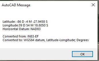

I am working with a routine that is supposed to list the long and lat of a picked point within the geolocation map inside civil3d.
It seems like the Latitude that it show when I pick a spot on the map shows all negative degrees mins and seconds. Not sure how to fix that.
Hopefully its something i missed.

You  can set the mins and seconds to positive by adding abs function.
; Convert Decimal Degrees to dms.
(defun convertDDdms (x1 / deg mins sec)
  (setq deg (rtos (fix X1) 2 0)                                    ;- degrees
        mins (rtos (abs (fix (* (- X1 (fix X1)) 60))) 2 0)         ; - minutes
        sec (rtos (abs (* (- (* X1 60) (fix (* x1 60))) 60)) 2 4)  ;- seconds
  (strcat deg "° " mins "' " sec "\""))
So -16.1382675 is showing up as
Latitude: -16° -8' -17.7630"
with abs added it will look like this
Latitude: -16° 8' 17.7630"

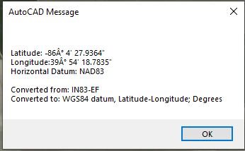

Great idea about that. It does make sense what you are showing.
I did run the function and it works, but i am getting a difference result with the degrees mins secs in the Alert Box. Not really sure why either.
-86° 4' 26.2201"
39° 54' 18.6891"
Not 100% but might be a rounding error. rtos Function
Is the same value being used? maybe @ronjonp or @BIGAL can fill you in.
-16.1382 returns
Latitude: -16° 8' 17.5200"
-16.1382675 returns
