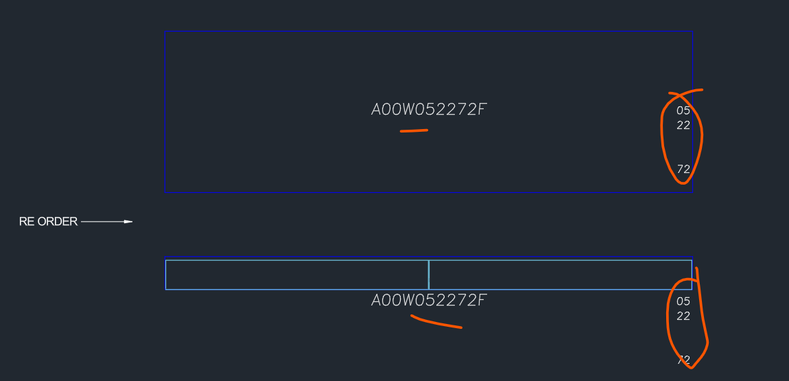

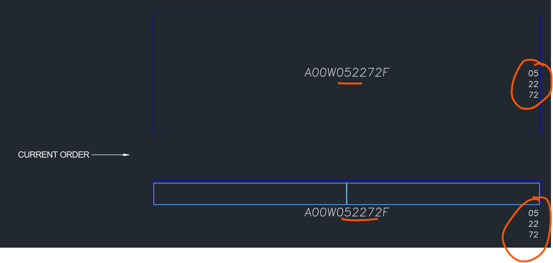

Find the attached file. I need to do sort all the blocks at a time.

@Rakesh H M even if you have a 1000 blocks if they are one block name and you do the BEDIT and Battman then as shown above they  should be updated, after Apply do Sync.
Can you please try this with attached file? I need to do sort all the blocks at a time.
Wood Master for testing.dwg
The blocks appear to be identical apart from the fact that each block is given an individual name. They appear to have the same attributes but in different order.
So my question is why do you not just have one block ? But with all the details different each time you insert that block.
Are you using some form of software to make the blocks ? The blocks just look to random. Are you copying and pasting from other dwg's ?
I think if you give us some background on how your getting to this point we may be able to fix it for the next dwg.
  • Agree 1

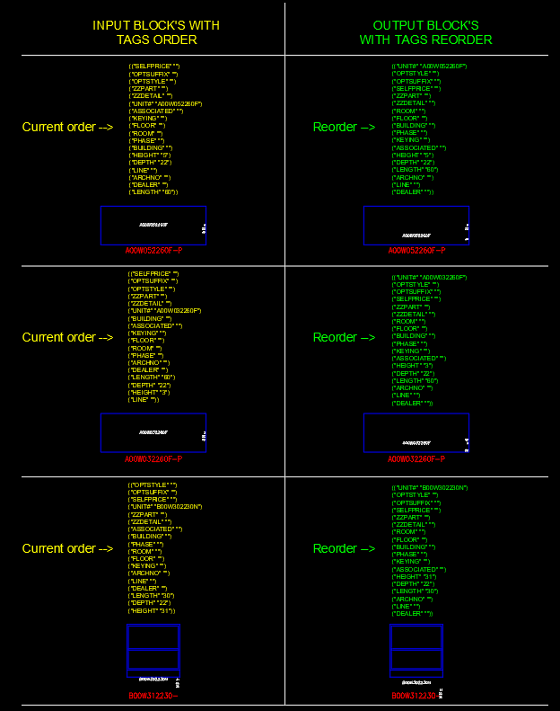

Hey @Rakesh H M,
Try this:
; Functions        :  RETAGS
; Description      :  Reorder TAG names with appropriate text values and layer names
; Author           :  SAXLLE
; Date             :  April 07, 2025
(prompt "\nTo run a LISP type: RETAGS")

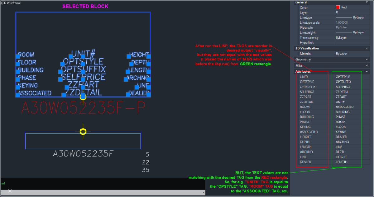

I tested it on your an example drawing (just on few blocks), and it works. See attached picture.
I hope it will be helpful.
P.S. I agree with what  @BIGAL was mention.
Best regards.
Notice: not fully tested, maybe some unexpected occurrence can happen.
NOT YET VALID AS ACCEPTABLE SOLUTION!!!
Edited by Saxlle
Not yet acceptable!

@Saxlle It works perfectly for my needs. Thank you so much!  @BIGAL Thank you!

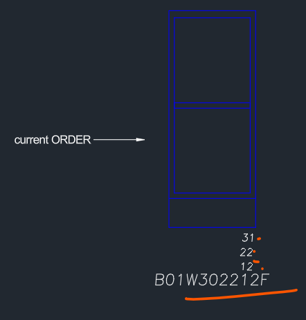

Its Architect request. They need individual blocks.  Each block represents each product number. It's not same. We use wblock command while creating. these are old blocks but Architect requested us to maintain Attributes consistency forrmat.

@Saxlle Attributes arranged correctly but I just find one issue with attributes locations. See attached pics.
Its moving everywhere not in original position. Is it possible fix this issue?

@Rakesh H M,
Honestly, I really don't know how to do reorder as it can be done in BATTMAN. Tried some options, but everytime I get as from the an example:
Maybe someone can help in this (it will be a good lisp for every other situation which are someone is going to have).
Thanks @Saxlle  for comment, I was looking at using vla getattributes reorder the list produced to match desired order then putattributes. I am not sure if it will work. I was editing the block definition so do a attsync after update of block. Working on one block may be easier. Will have a play when I have time.
I'm also tried that, after reorder TAGs, use attsync, but then somehow the all TAGs again change the order.
Happy for that, maybe we can find a right solution for that.
@Saxlle We're almost there, but this is the only issue we're facing. Thank you for hopping in and creating the Autoslip.
@BIGAL Let us know if you find the right solution to fix both issues.
