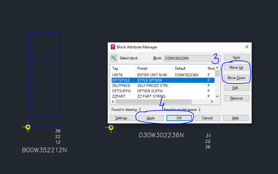

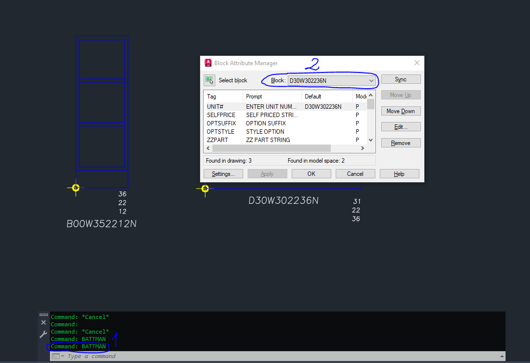

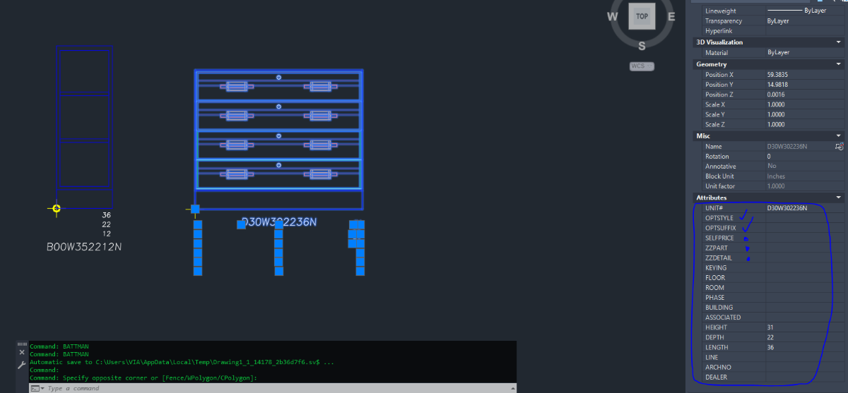

Saxlle Posted March 31 Posted March 31 (edited) Hi @Rakesh H M, You can do it on this way (without lisp): 1. Use command "BATTMAN" (picture 1); 2. Choose from "Block:" the desired name of the block (picture 1); 3. Use buttons "Move Up" and "Move down" to sort the attributes tags in desired order (picture 2); 4. After everything is done, use the "Apply" and then "OK" button to apply to every desired block (picture 2). 5. Output (picture 3). I didn't sort everything, just a few. Picture 1. Picture 2. Picture 3. Best regards. Edited March 31 by Saxlle Quote
