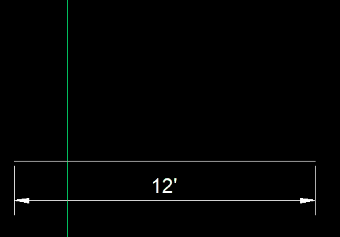

Efeezy Posted May 7, 2021 Posted May 7, 2021 Good Morning: Does anyone have a polyline lisp with a specific dimension? I am placing electrical receptacles in an apartment complex. The polyline needs to be a total of 6'-0" or 12'-0". The polyline will bend around: corners cabinets and pillars. The poly line will not be longer that the predetermined length. Thank you for your time, Efeezy Quote

Efeezy Posted May 7, 2021 Author Posted May 7, 2021 Ok, I see where you are going with this. I want to draw a poly line and have the length at 6' or 12'. The way the LT lisp is set up it takes an existing pline and makes it a specific length. Quote
